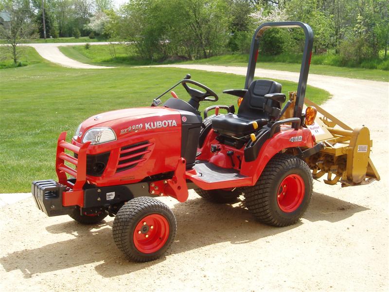

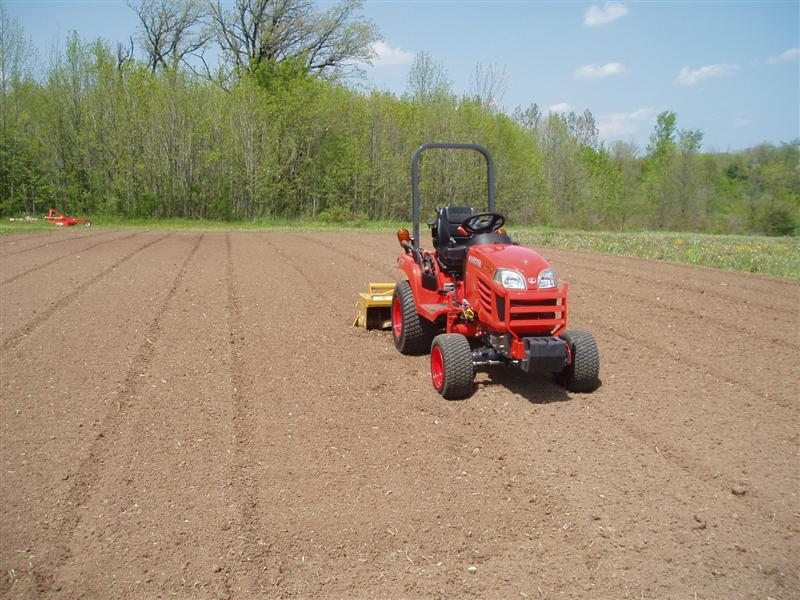

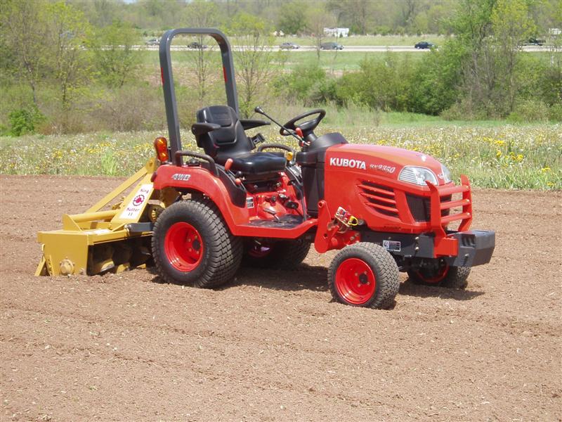

Finally able to get out and prepare the seedbed for planting. attached are some pics of the setup. Works fantastic!

Ok, several questions...
1. Did that tiller cause your BX2350 to lug at all?
2. I have that same tubular grill guard, but I don't have that area to mount the weights... did you add that?
3. Ditto on the arm rest question... are they in a position to actually use them?
4. Why is your BX so clean after all that tilling? Did you clean it for the photo op? :D
Thanks
Jesse

/ BX With 48" KKII Tiller
Thanks
Jesse
*Typically in most soil conditions RPM's drop about 200-300 if that. IMO the 2350 has plenty of power to drive the gear drive tiller. No complaints.
*Yep, I took the OEM grill guard and added a 1/2 steel box frame to hold the suitcase weights.
*Answered in previous post
*We had 1/4" of rain the night before so there was very little dust during the tilling operation the following day. But I will confess, I did wash it the night before when it was raining...I was bored
