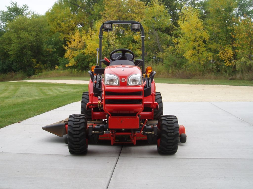

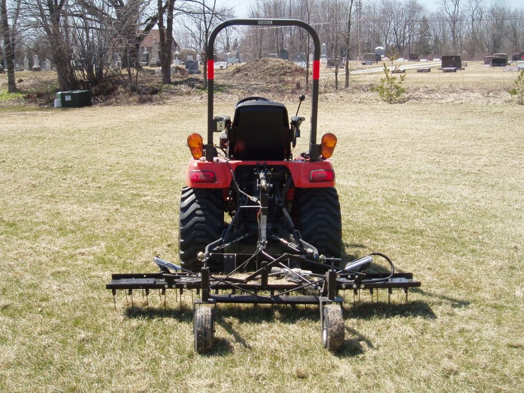

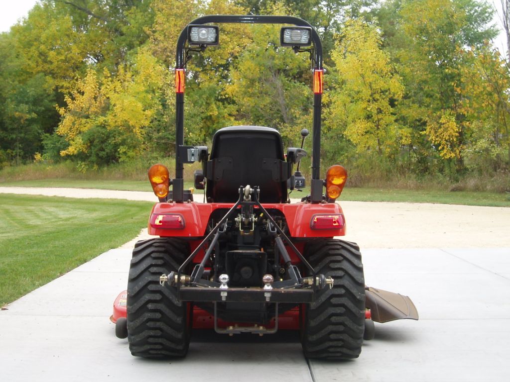

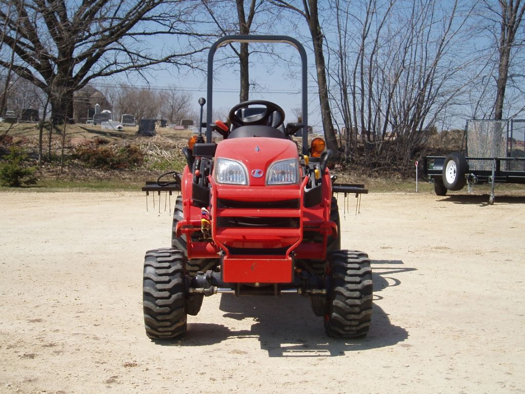

Before and after. Very pleased with the results on terrain.:)

2" both front and rear. I did have to adjust the steering stops (front) to prevent the tires from contacting the 60" MMM. Not a big deal. It did however reduce the steering radius a bit. Without a MMM it is a non issue.
As stated in previous posts a 60" MMM is required when installing spacers, the 48" & 54" do not accommodate the added width because of the gauge wheel placement.
