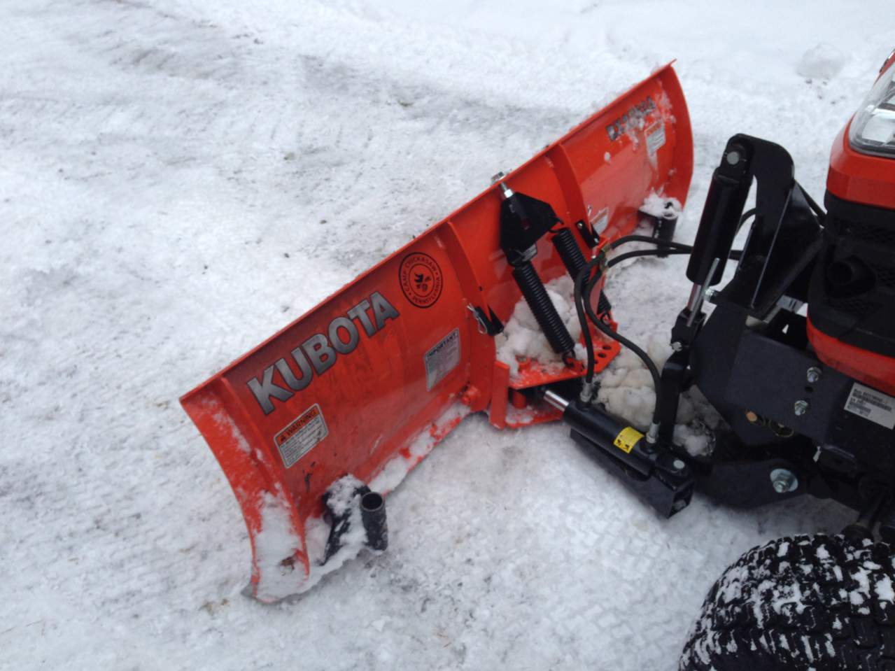

We moved to our property in November and are now there full-time, so this is my first winter maintaining the driveway on a regular basis. Last fall, we got a BX 2370-1 with loader/forks, mower, and frame-mounted 60" hydraulic plow to replace our old Cub LoBoy and JD 425. Our driveway is about 1/3 mile long with some open spaces in front of the garage, barn and turn-around. It takes four passes on the drive with the blade angled. To plow everything it takes between 1:15 and 2 hrs depending on how deep the snow is. On a nice weekend day this is OK, but not at 6 AM when its still coming down and is 10 degrees out. A truck plow would be the way to go, but is not an option.
We have been thinking about getting one of these Original Tractor Cab enclosures for our RTV1140
http://www.wiedmannbros.com/Soft-Top...40_p_3776.html
And, with this enclosure, I am wondering if I should get a plow for the RTV and sell the BX plow. I like the looks of the BOSS 6' poly straight blade. The enclosure would definitely keep the weather off of me and the RTV can travel faster than the BX, which tops out at 8 MPH. Of course, I'm not going to be plowing at 25 MPH with the RTV, but with an extra foot of blade width and 10-15 MPH in the straight aways, I would think that I could shave some time off of the chore.
Any thoughts?

I would say go for the RTV, but I would see if you can get the V blade. It will be much faster to do those open spaces in "scoop" mode than a straight blade. Also, a cab makes clearing snow nice.
Aaron Z

Can you up size the plow on the BX at all?
If its like the one on our BX2660, these wings are reputed to fit and should add another 10" to each side.
Aaron Z
   / BX vx RTV snow plowing
That is in interesting thought, adding wings to the plow. Can anyone report on whether it is still effective at plowing after adding ~20" of width? I could add an OTC cab and wings to the plow for about $1100. If effective at plowing, that would address all issues except for travel speed, but if clearing a wider path, then that is less important.
The plow that is on the BX now is 60" wide. Model #BX2763A.
I hope to get those for next winter, Our BX has plenty of power, but needs a little more width when the blade is angled.
I got the idea from a thread here on TBN (http://www.tractorbynet.com/forums/snow-removal/213300-plow-wings-60-blade.html)
See also: http://www.tractorbynet.com/forums/...ng/158803-snow-wings-extensions-54-blade.html and http://www.plowsite.com/showthread.php?t=53191 (install pictures on a truck plow)
