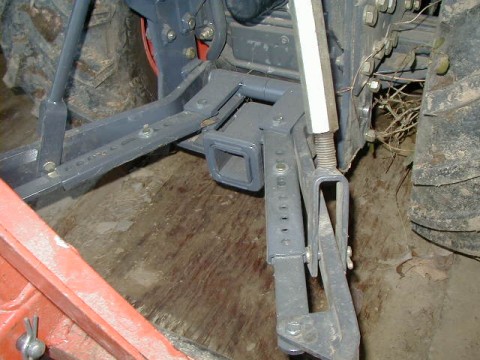

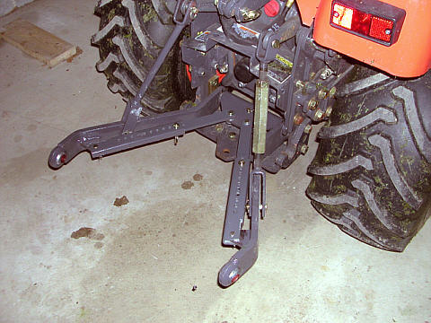

I just got a set made for the B2710 like previous post suggested. My question is, most of the pics I've seen of these retrofitted show a bolt used to mount the flat stock to the tractor. Don't you need to use the clevice on the ends so they can move up and down independently of each other? Most of the time, I have my hitch arms at the same height, but can forsee adjusting these when I use my boxblade. For those who have made this modification, what are your thoughts?

I think you are right. Here is a picture that someone posted that did it differently. I remember he had his brother-in-law fabricate what he needed to make both halves move independently.
I plan on doing something similar on my BX in the future...
Sorry I don't remember who posted this photo... /forums/images/graemlins/blush.gif

The 3pt on the BX22xx is not removeable and is different than that on the BX22/BX23--the whole rear end is constructed differently due to the 'hoe subframe, etc. That said, you can install the telescoping lift arm stablizers to the best of my knowledge. Attached is what my BX22 installation looks like.

Unless I am missing something that looks identical to my BX2200... /forums/images/graemlins/confused.gif
I mean the original parts that remain after the installation of the B2910 parts...
