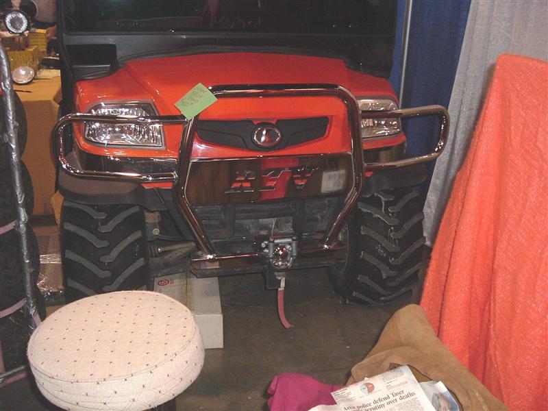

I haven't seen the RTV with the R4's that are on the new 2350's, but I have seen them with the bar tires and wheels, no spacers from the earlier BX's, wicked looking machine.

Nwood said:
Milkman,
Any word on how that rtv got around with the bar treads?
That RTV was a the Farm Machinery Show and it belonged to one of the exibitors that was selling aftermarket lights, it had a turbo and twin stacks, don't know how it did. With the weight of the RTV it should have some good traction, of course the 589's should also.
