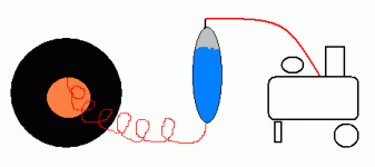

I just installed my LA211 Loader yesterday and I need to fill my rear tires with some weight.I've read here that some of you guys are use Windsheild Washer Fluid, But how the heck are you getting it in there?

I unscrewed the center of the valve. Positioned the valve stem at 12:00. I then built a contraption out of a small (2 1/2 gallon) air tank. The air tank had an air line running out of the bottom of it to the tire. The top of the air tank I put on a quick connect air fitting. This fitting gets removed to fill the air tank with windshield washer fluid. Put the fitting back on and pressurize the tank with an air compressor. This forces the washer fluid into the tire. Once the tire is inflated, you have to take the air line off the tire to let the air out and then force more washer fluid in until the tire is full. Only fill to the vavle stem with the stem at 12:00. I think my BX2200 took 11 gallons. I attached a crude drawing so you can get an idea what I'm talking about. That's 11 gallons per rear tire. I didn't load my front tires.

I thought between 12 and 13 gallons per tire. This was for the BX 2200 22x12-12 bar tires. BUT the chart at tractorsmart.com says 10 gallons per tire. I will have to look and see if I wrote it down somewhere.
Best to have a couple extra gallons on hand. I by mistake got some "Summer blend" mixed in with the winter stuff, and had to go get a couple gallons more of the winter stuff in order to complete filling the second tire.
I did fill to the valve stem, with the stem at 12 o'clock, and the tire jacked off the ground. Pressurized to 12 psi I think, before lowering the tire back down.
Chances are pretty good if you buy 24 gallons you will have several left over to use in your vehicles... /forums/images/graemlins/smile.gif Wish my memory was better on the exact amount I used... /forums/images/graemlins/blush.gif
