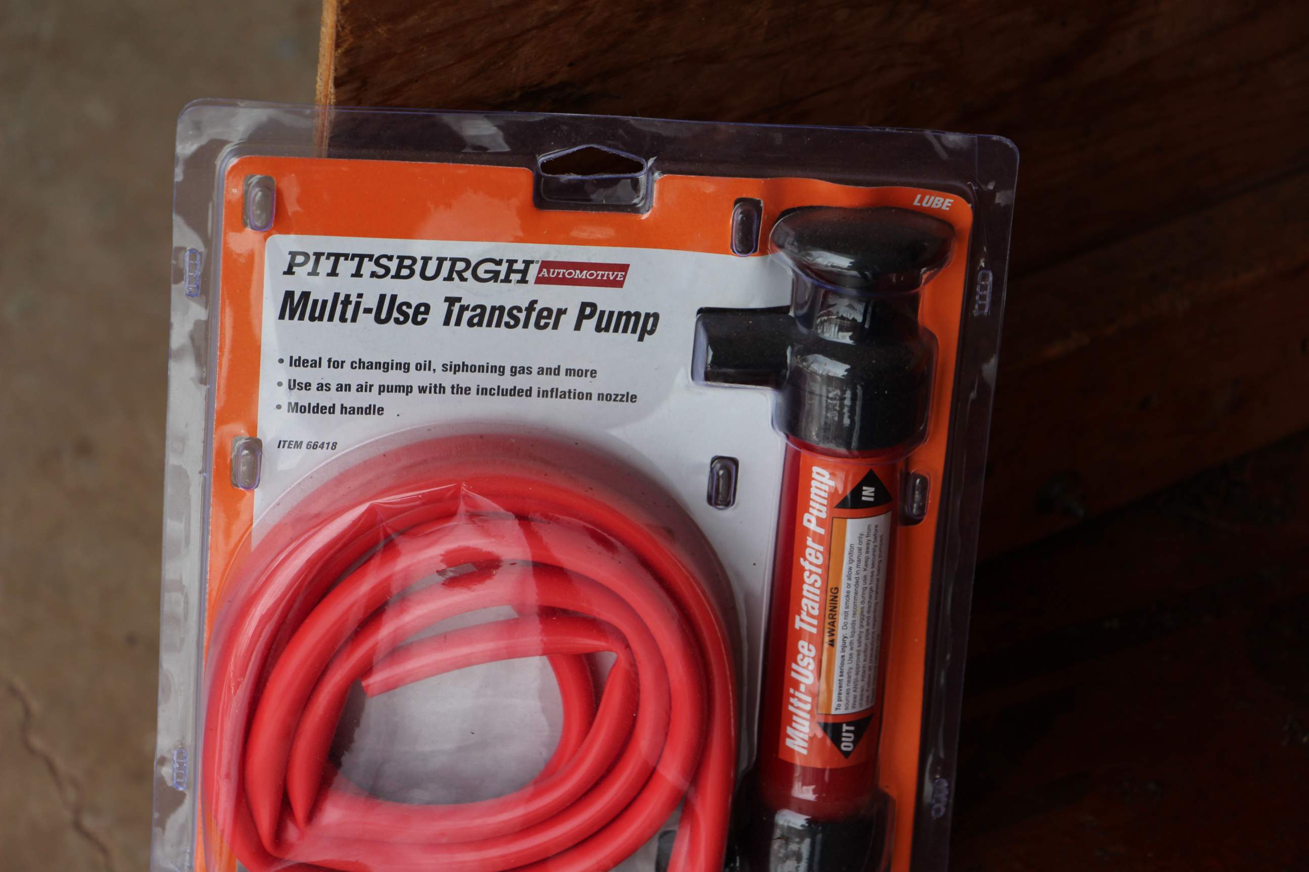

I changed the gear box oil on my rear-mounted snow blower and found it to be a pain in the neck, as there was no drain plug, only a fill plug on top. I bought a $7.00 transfer pump at Harbor Freight. In the future, I plan to pump the oil out. This is just a thought for you to consider.

I took a pick of the transfer pump that I bought.
