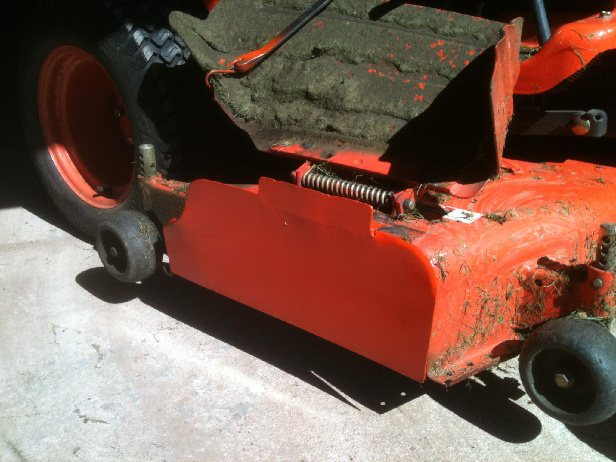

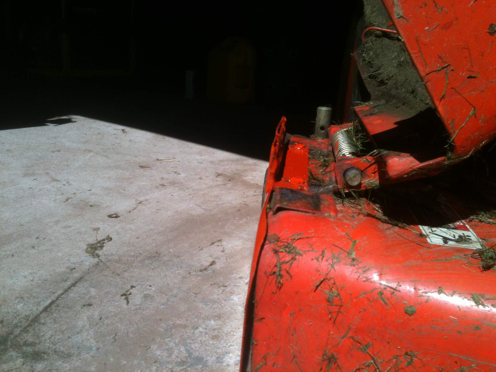

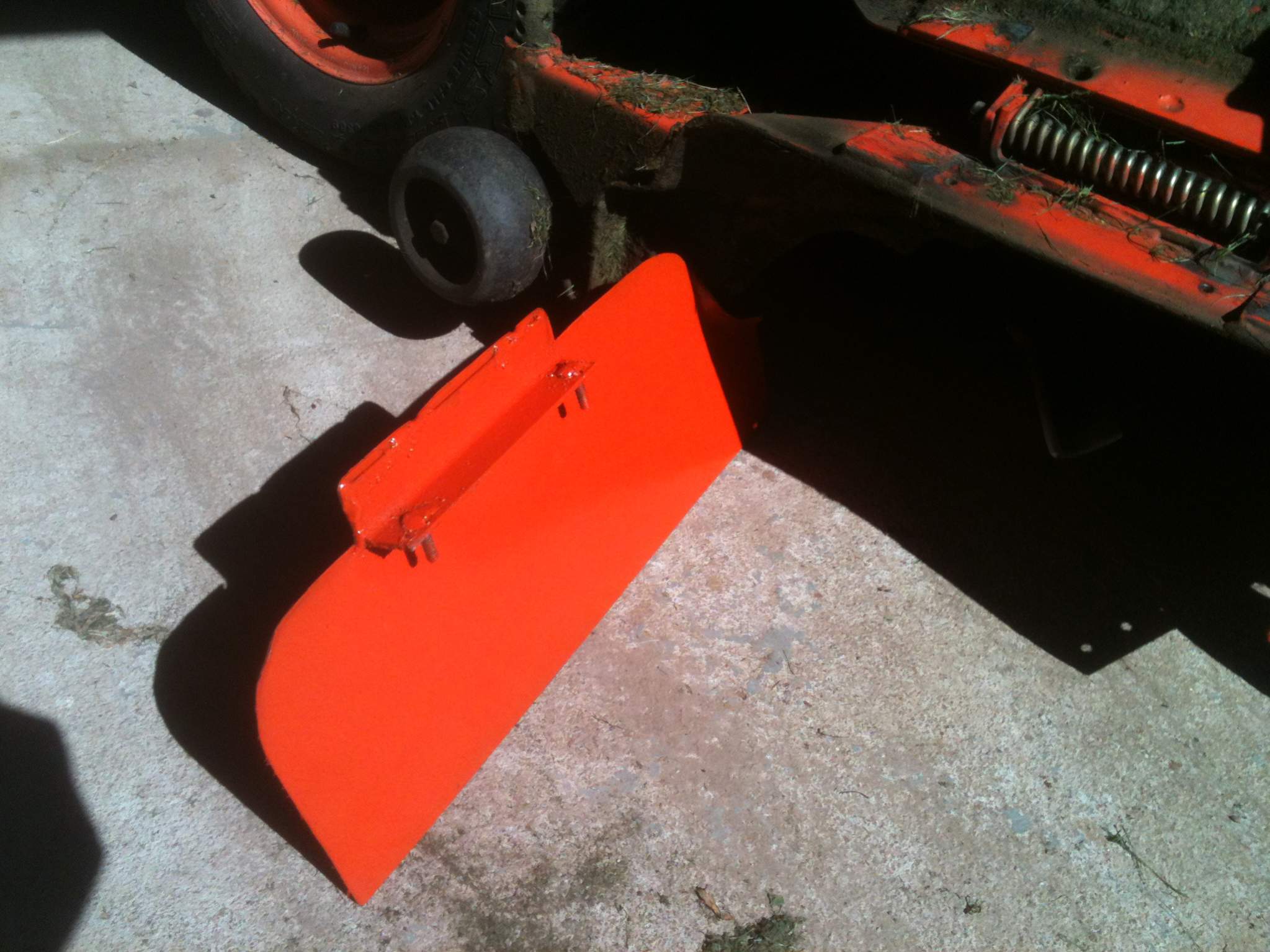

I made my own mulching kit. I took a piece of heavy gauge sheet metal, cut it to fit the opening of the discharge chute, welded a piece of angle iron to the top of the sheet metal and then welded two 1/4 inch bolts to the angle iron. Theses bolts act as locating pins for the two holes I drilled on the top of the deck.
The whole thing just drops into position and blocks off the side chute.
Works pretty well.
The spring tension from the deflector chute holds the thing in position while mowing. 008.jpg007.jpg009.jpg
