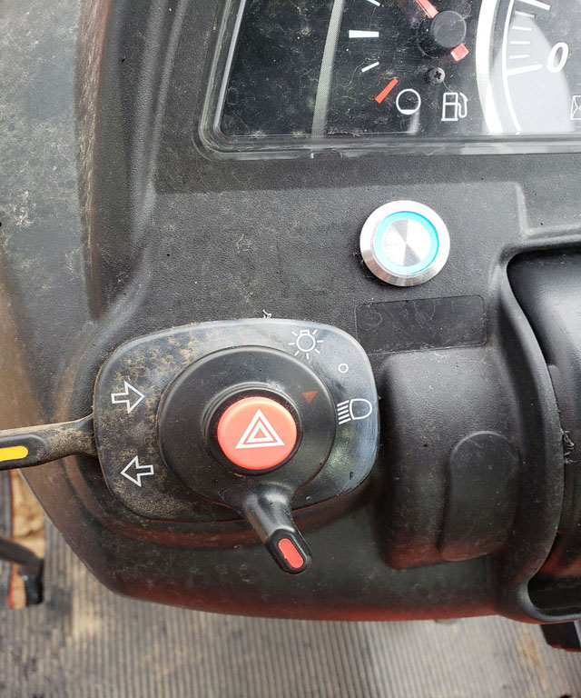

These LED'S are 60W per light front and side floods for a total of 240 watts.
I would have put more but that's at or near the maximum amps can pull.
Mounted a lighted weatherproof switch that lights up when the LED'S are on near the headlight switch.

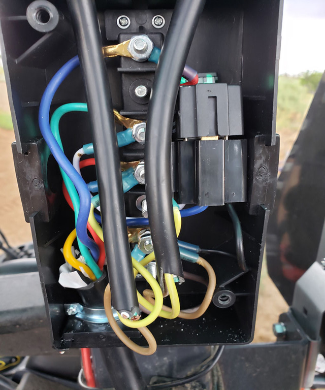

Used a trailer wiring box for a clean water proof install.
Put a relay in wiring box with a trigger when the key is on.

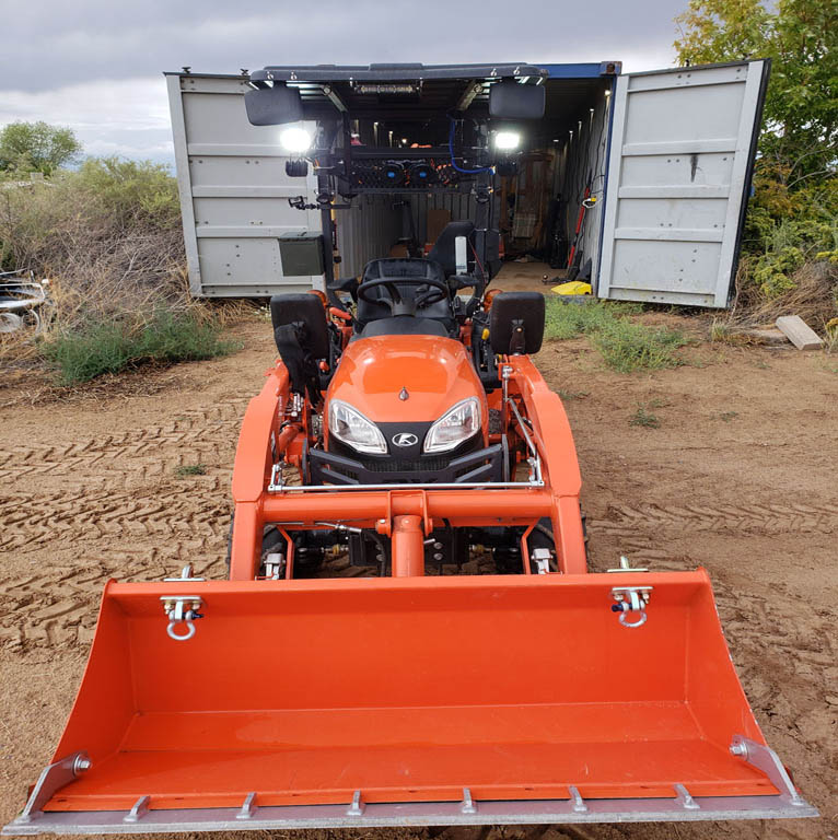

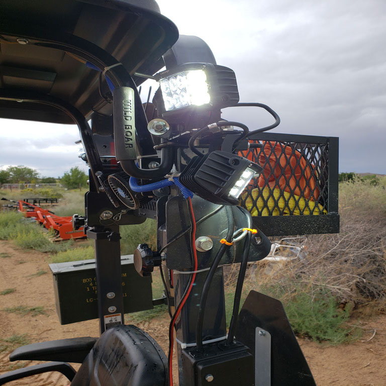

Mounted LED'S on the ROPS on each side with a bracket.

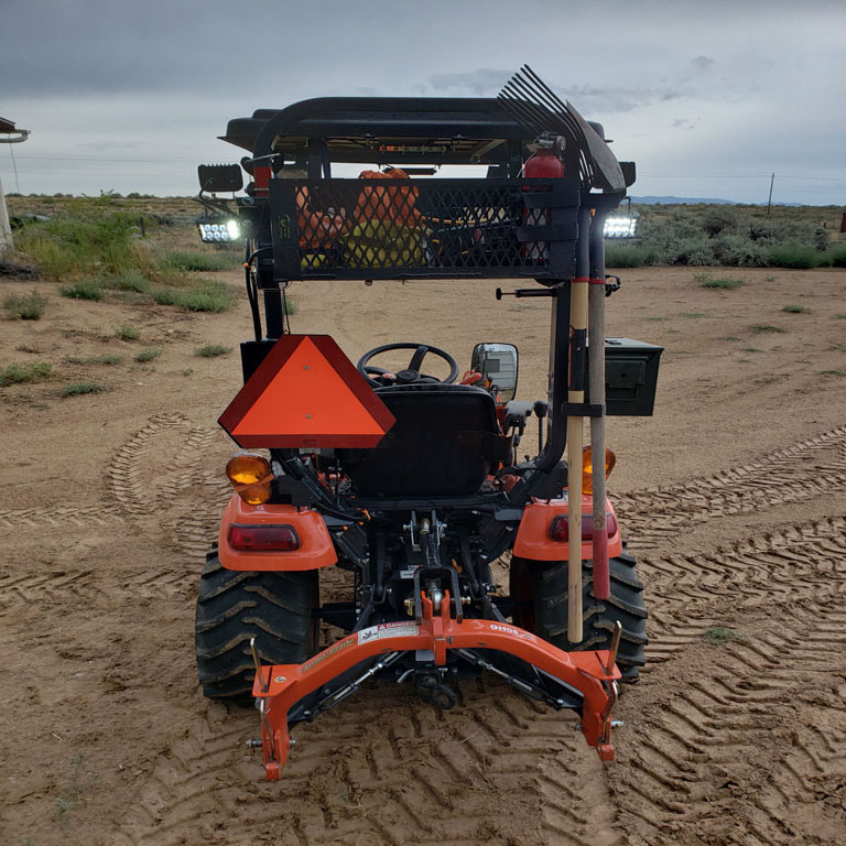

Front view & Rear view.
I may be small but I will be SEEN!:cool:

For the record I have strapped to the ROPS-
1.Basket for tow cable, chain & a fire extinguisher.
2. Tool box.
3. Shovel, Pitch fork.
4. lights
5. Canopy
6. Go pro (knock off) mount.
:cool2:
As far as the lights, they are from Amazon and called " oEdRo Side Shooter LED Lights"
Yeah not a name I recognize either but at only $46 a pair they kick donkey butt!:thumbsup:
here is the link.
https://www.amazon.com/gp/product/B074KZKJ32/ref=ppx_yo_dt_b_search_asin_title?ie=UTF8&psc=1
As far as the wattage, well why do something just right when you can over do it!:drink:
If I need to work in less than perfect light I want them to light my path like the SUN!:shocked:
