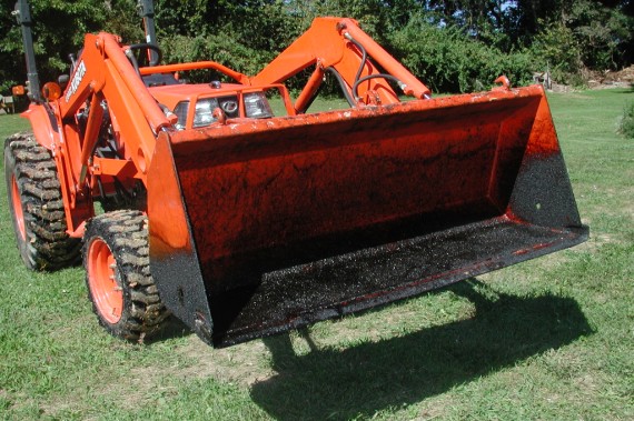

Has anybody ever spread out asphalt, coal mix, oil dirt or other similar material using only the FEL? If so how did the job turn out? I'd prefer to use asphalt but was wondering how good of a job the BX would do while rolling over it and packing it. Maybe a front blade would do the best along with using the turf tires???

If you have asphalt delivered, you wont be able to spread it fast enough before it cools/sets up, will you? Why not let the asphalt co spread it with their big equipment rather than wreck yours?
Just a thought.
/ BX - Implement to spread asphalt? #3
I second Av8r2230 on this. Temperature is very important, the asphalt must be around 284ºF when applied. You need at least 2" compacted (2 5/8" before). Ouff... this seems to be a tough job for non-experts without the right equipments. /forums/images/graemlins/confused.gif Maybe other TBNers have other opinions.

Well...my experience with the asphalt is a bit different when it comes to temperature.
A year ago (actually Sept, 2003), in warm weather, I was giving $10 per load to some truck drivers for fill. Worked for them and worked for me...
Anyway, I got all I needed, and a couple days later I hear a truck stopping, so I head up from my shed and the guy had about 10 tons of asphalt from a state road project, that was excess and he was going to dump it somewhere down the road...so he asked if I wanted it. I said yes, for sure and paid him $20 for thinking of me...figured it was worth a case of beer to me... /forums/images/graemlins/grin.gif
I never played with asphalt before and it held the temperature fine. I was amazed at how much fun it was to spread, almost like sand or small curshed stone really. My R4 tires (B2910 Kubota) did a fair job at "rolling it" and all in all I was satisfied, considering the investment. It hardened up rock solid. I had no complaints.
Now if this stuff cost $20 or more per ton, I think I would rahter have a proper roller and get a smoother finish that way. Turf tires would work better than R4s I guess. I don't have a clue what asphalt costs...and that asphalt I put down now is under some other fill...so all I know is that it was quite durable for a year or so.
Diesel fuel on the bucket did nothing for me to keep the asphalt from sticking, but the way. If you do use the tractor to play in the asphalt, be prepared for a mess on the loader. But it will wear off in time...
I'll attach a picture to indicate what you can expect to see afterwards if you decided to play in the asphalt with your BX...

</font><font color="blue" class="small">( in warm weather,... worked for me...)</font>
The warm weather is probably the key. The asphalt should hold much more of its inner heat if the outside temperature is 100 degrees as opposed to 20 degrees. Though the flash point of diesel fuel is fairly high, think about how much more easily the engine starts on a 100 degree day as opposed to a 20 degree day.
If you try this, doing it on a day when the temp. is expected to be really high would be your best opportunity.

For most cases, if it is a reasonably warm day you will have plenty of time to work the asphalt. Most of the smaller patches the state highway departments do are rolled with grader tires and pickups. USUALLY diesel on the FEL before hand will help with the sticking (there are several "release agents" asphalt companies have). Smooth it out with FEL, there wheel roll it with your pickup. For a driveway that doesn't have much traffic (compared to a highway) you'll do fine. Millings work great also, but around here they are hard to come by.
