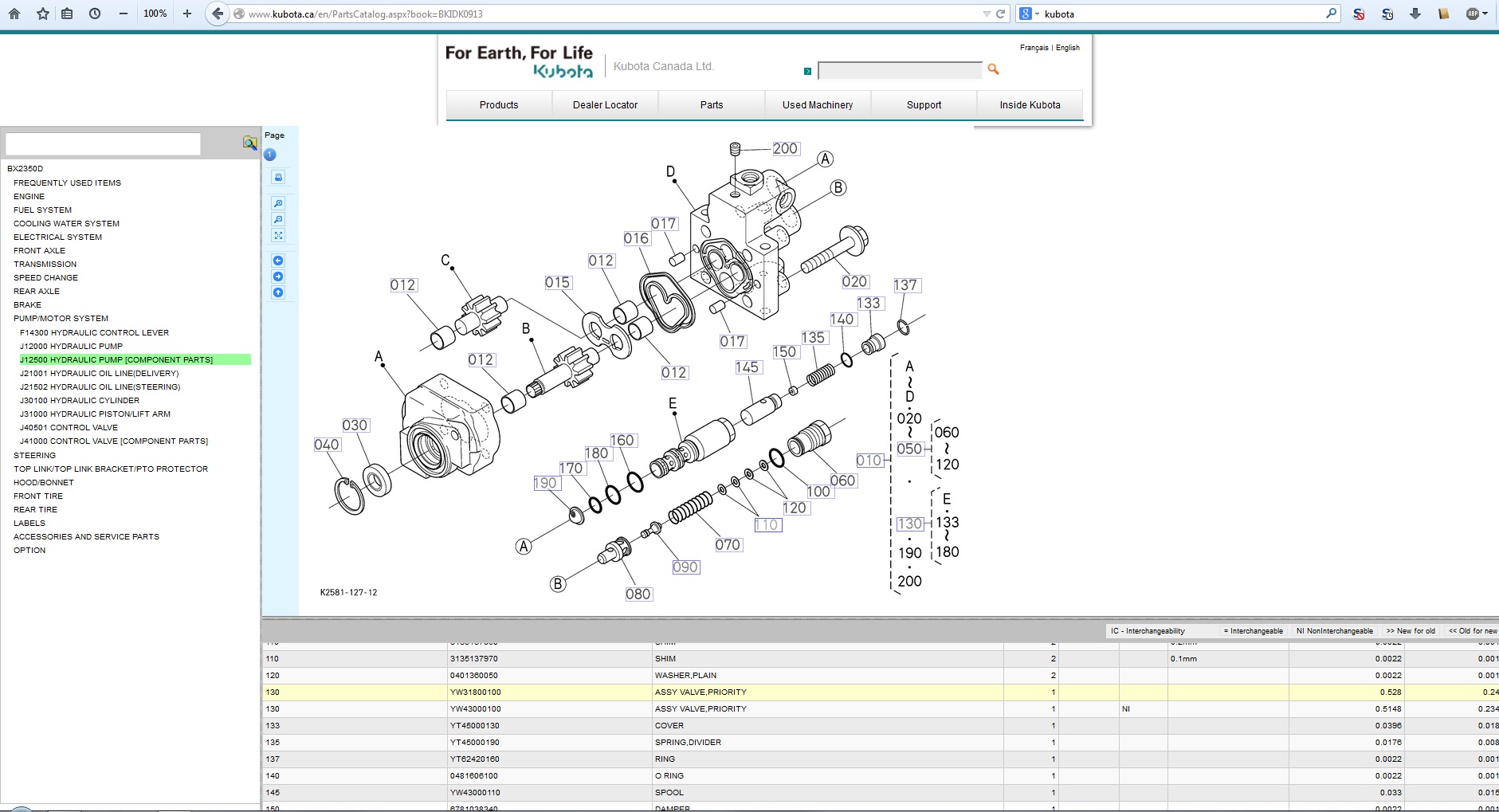

A while back I picked up a pressure gauge to test the pressure relief valve setting on my BX2350. It was reading about 1,700psi so I got some shims from the dealer to bump it back up closer to the 1,850 max setting.
I put in 0.3mm of extra shims hoping to get a new pressure of about 1,820 (0.1mm ~= 39psi). Surprisingly, the pressure jumped to 2,500.
Not knowing why it jumped so high, I removed the shims I added and retested. Pressure stayed at 2,500.
Now what... So I then removed the two shims that came with the machine from the factory (I purchased it new) and the pressure dropped to 2,000. (remember I started at 1,700)
One thing that I found interesting was there is no torque spec for the plug used to access the spring/shims. However, it sure would seem that engaging the plug an extra thread should have the same effect as adding more shims?? As a test, I loosened the plug and just hand tightened it. Even with the plug in just a minimal distance, the pressure remained at 2,000.
I did check for particles under the shims and the spring.
Note - All pressure measurements were made on the loader ports with the engine at 3,000 rpm.
Any ideas as to why I can't get the pressure back to at least where I started?

The attachment shows what your relief/pump looks like.
Section "B" is your relief. I wouldnt go rooting around in there with pliers willie nillie. There are machined surfaces in there, do not scratch in other words. You need something soft. Even a magnet will likely be enough to remove the seat and poppet (#80 and 90).
While I was at it Id probably pull apart section A, the priority valve as well.
Watch what you use to clean it out. Brake Clean can damage Orings so be careful if you use it. A tiny spec of dirt can be enough to hang things up Bx hyd.jpg

Alright, I got into the PRV a little more and was able to remove the poppet (item 90 in Scooby's IPL above) using my magnetic retrieval tool. Nothing looked out of the ordinary and there was no obvious debris that I could see inside the housing. The tapered surface of the valve body looked clean as well.
However, I was not able to get the valve body (item 80) to come out. I was able to hook an allen wrench inside the body but it wasn't budging. Not sure if there is a technique involved with getting this out but realistically, I'm also not sure if it is that important at this point.
I also removed the priority valve body and found nothing there either.
So after all this, nothing has changed on the pressure (didn't expect it to). It is still right around 2,000psi. I also put the gauge on the other loader ports and got the same readings.
Is it possible that something about the spring from the PRV is causing this?
Also, I went back and reconfirmed one of my earlier tests. With the PRV plug barely installed, the pressure test gives the same results as when the plug is fully tightened. I would have expected the additional turns to have a similar effect as adding shims. Any ideas on that?
