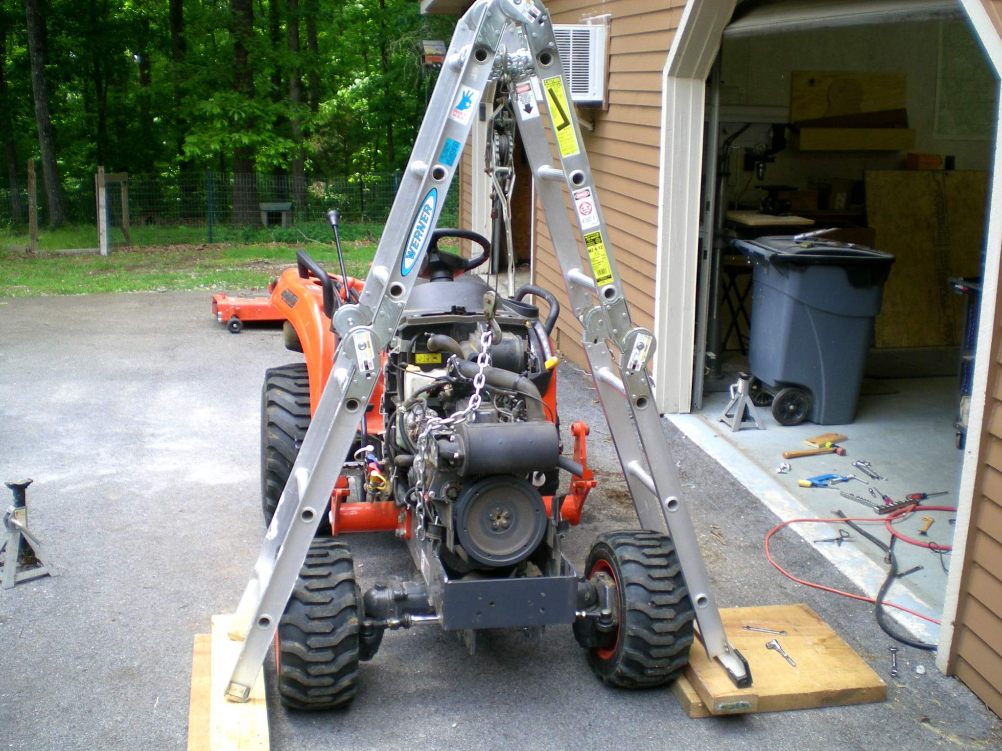

I took a look at the threads on this site and others, considered alternatives, and decided to go ahead and replace the fan. Using the step by step guides over several threads, I ended up spending about 5 hours, with a few breaks, to take the tractor apart and put it back together. The actual time replacing the $9 fan was about 5 min.
Here are a a couple of things I learned that may help someone who isn't a tractor mechanic. It was easier for me to take of the rear tires and unbolt the PTO, transmission and other leavers rather than try and get the rubber tips off of each one. Rear fenders came off easy after that. Also, the MMM lift arm depth control knob is much easier to deal with if you just unbolt it from the bottom rather than trying to take the knob off the shaft. Next, don't try to lift the engine until you have disconnected the drive shaft from the engine; with only three bolts it's easier than it sounds. Lastly, have someone underneath the tractor holding the drive shaft back when you lower then engine. Otherwise, the rear of the engine may not seat down on the mounting bolts, rather it will get stuck on the top of the drive shaft.
My next adventure is building a skid plate so I don't have to replace the fan again. My 2360 came with a factory skid plate, but it didn't stop the stick that got up into my fan. I attached a picture my redneck-engineered engine hoisting device for y'all's personal amusement and edification.
Mike
   / BX: How is your alternate HST fan replacement solution holding up? #6
redneck hoist ? I dont think so. Its making do with what you have. good thinking!:thumbsup:
