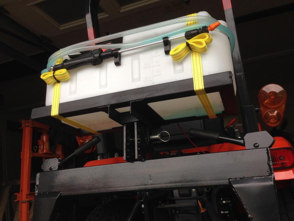

Just a couple of the things i made. A frame for my tomato sprayer which sits on my harbor freight quick hitch, and my trailer/log splitter/utility mover.

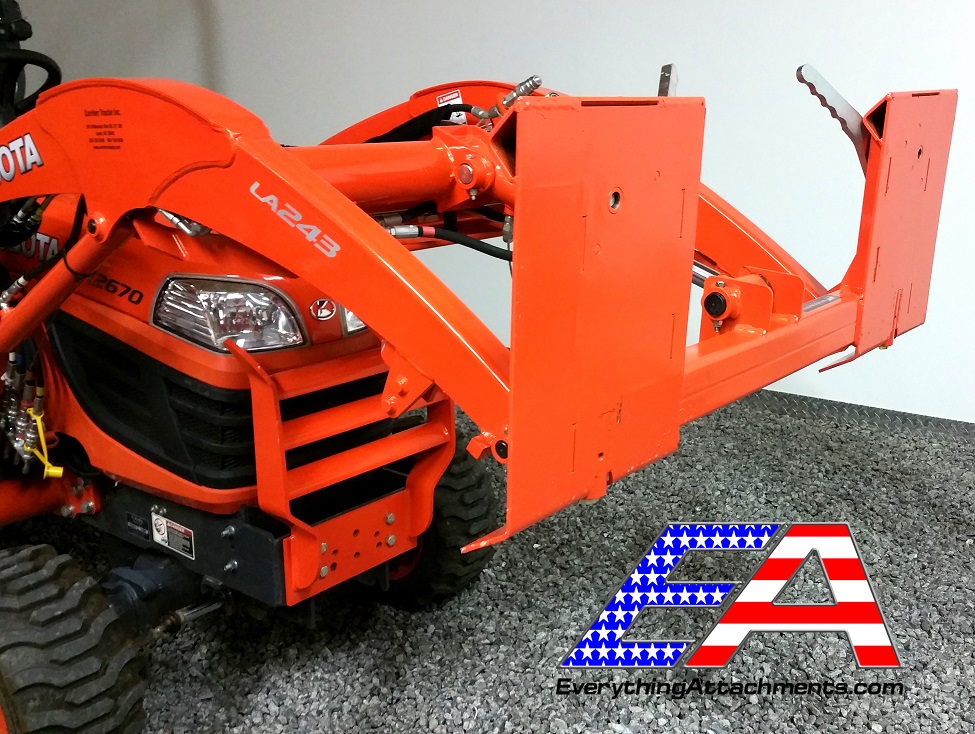

If you are gonna mess with loader implements, get a SSQA kit. The world is your oyster & you now have access to a world of tractor & skidsteer impliments. Takes a minute to change em out.

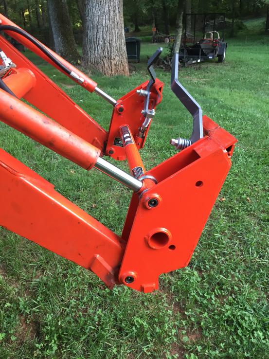

I have the QH for my BX25 FEL. If the BX25 bucket pins are the same as yours it should work on your earlier BX. I am in the process of making a piece of 6" channel to fit the QH. then I will make forks, grapple and other items to fit the Channel assembly. Plan to have a way to attach a 3PT QH to the channel assembly also.
Ron
   / BX home made loader arm attatchments? #8
I have the QH for my BX25 FEL. If the BX25 bucket pins are the same as yours it should work on your earlier BX. I am in the process of making a piece of 6" channel to fit the QH. then I will make forks, grapple and other items to fit the Channel assembly. Plan to have a way to attach a 3PT QH to the channel assembly also. Ron
Harry at bxpanded.com told me quite a while ago that he was going to fabricate a QH mechanism for the BX25 FEL which would accommodate palette forks that are right up against the loader arms instead of out at the end of the bucket like the ones he makes now. However, I have been unable to get an update from him on that project.

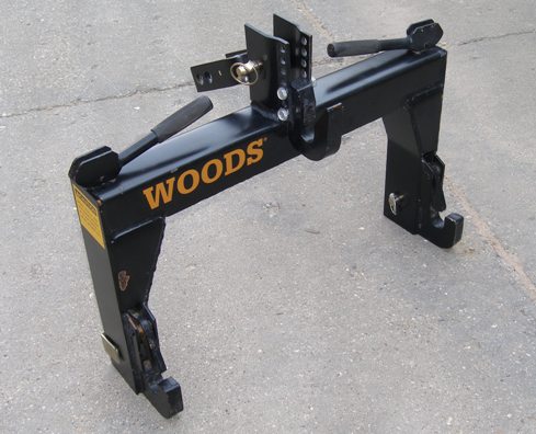

Just to avoid confusion, a QH (Quick Hitch) mounts on the three point and connects three point implements to the tractor.

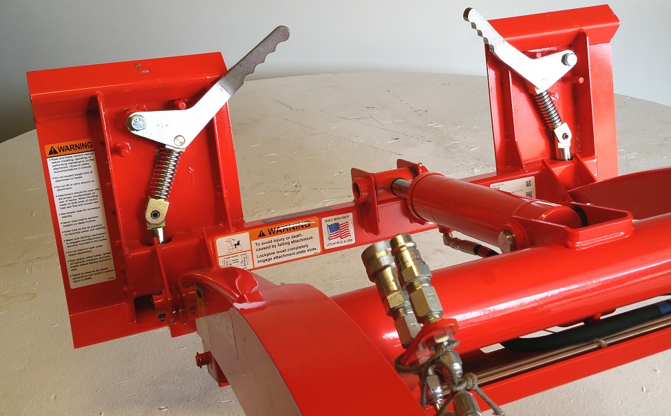

A QA (Quick Attach) mounts on the FEL (Front End Loader) and connects attachments that have a SSQA (Skid Steer Quick Attach) plate on the back.
