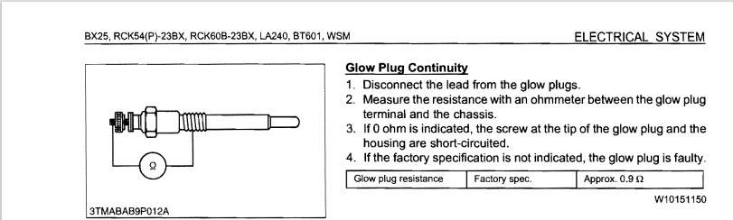

   / BX glow plugs - current draw favor #6
Here is the required GP reading from the WSM. 0.9 ohms

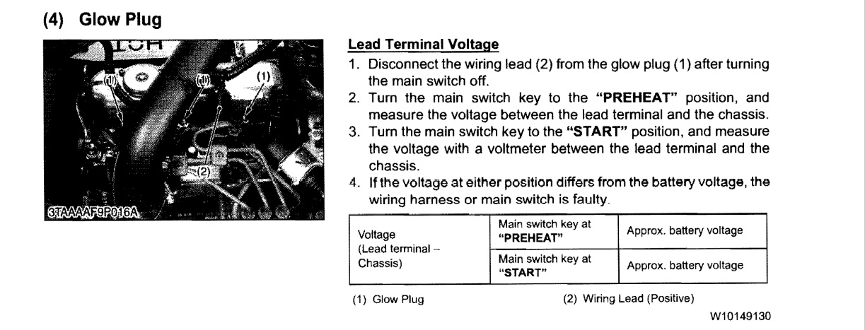

This next test is to verify the GP's are being powered both during PREHEAT and also START on the key switch.
I have not readup on how your GP's on time is controlled. If it is all manual then the block heater is no problem.
If there is a controller using the engine block temp to determine on time, the warm block results in a very short GP on time yet the engine is inhaling very cold outside air and can have big problems getting fired.
Since you are not currently concerned with using the block heater then focus on the condition of the GPs individually and also the key switch in two positions mentioned.
Tell me about your fuel supply. Do you have a bulk tank, do you buy and bring home in cans, if so where and when do you buy. I see many people buying and then trying to use fuel from warmer seasons in very cold weather perhaps by using some mechanic in can as an additive.
Dave M7040

Thanks for this info Dave, much appreciated. I'll give this a try when I get some time after work some evening. I believe the BX is fully manual on the GP, the key is spring loaded in the GP position and when you release it the current disappears. I'll test the leads in the start position while I have it disconnected.
Fuel supply is 2 plastic 20L jerry cans. Homeowner with no other diesel equipment. Guaranteed some of it is still summer diesel, I don't think they switch to winter diesel here until the fall. I've had the pre lift pump filter freeze before, which is common on these since there is no separator. Since then, I've treated all the fuel with 'diesel-mate' and have had no issues since. It runs at full power/RPM with the snowblower no issues, so I don't suspect a fuel delivery problem. In fact, I went through a whole tank cleaning the yard after the most recent snowstorm.
