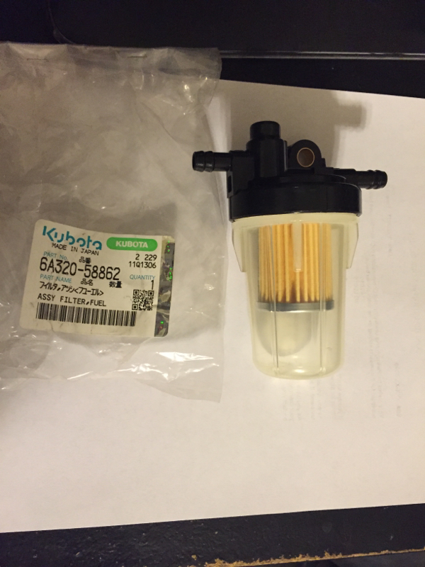

Hi guys, while operating my bx25 last week it sputtered a couple times.
Soo i figured maybe my fuel filters were due to be changed.
Looking in manual i believe it said 500 hours.
Well my bx has 188 hours. I only buy fuel from 1 busy Shell station down the street.
Sells a lot of diesel.
Also has always been filtered through a mister funnel...
I had the filters so i said why not change them, they are cheap anyhow.
Well after taking first filter off under tractor it was apparent this was the problem very dirty. But how? Next filter was clean. Tractor runs great again... But i want to upgrade to a b or l style filter. Any links or info appreciated thanks guys...:)

get one of these. They are only $16 from your Kubota dealer an work great. They are from the B series they said. image-3419306479.jpg with a little fabed up bracket by the pump it works great.
   / BX fuel filters what gives... #5
Thanks for posting the picture Jj

Does that filter have a fuel shut off valve on it?
Unfortunately, No...The filter on the older B1700 I had had a shut off but the newer style as pictured that is on my B2650 does not.....Must have saved bota a few pennies on the assembly line..Sadly, I am starting to get the feeling that that the new stuff they are building is not living up to the tough and reliable reputation that the company earned in the past.
   / BX fuel filters what gives... #9
My B2320 does not have a manual shut off valve but once you remove the bowl there is a spring loaded valve that closes the petcock and prevents fuel from spilling.
   / BX fuel filters what gives... #10
abeal....so it automatically shuts the fuel when the bowl is removed? Pretty sure my filter is the same as you describe and I wasn't aware of this. So you do NOT have to pinch off the fuel flow when you replace the filter element?
