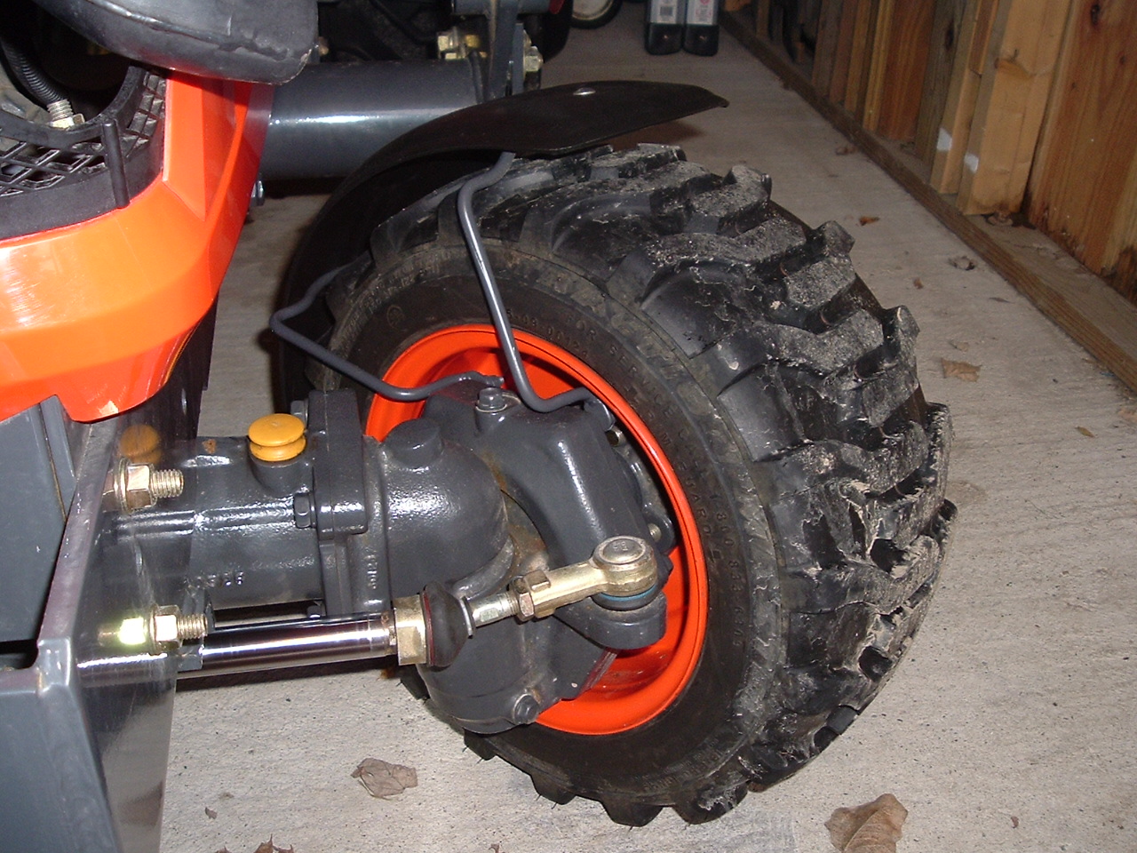

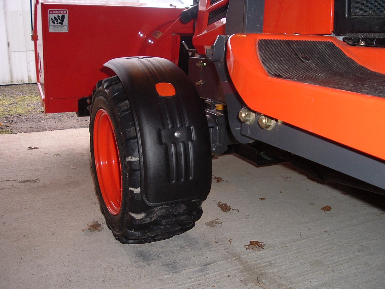

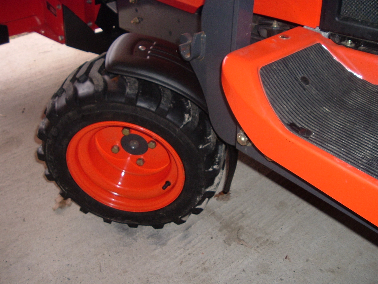

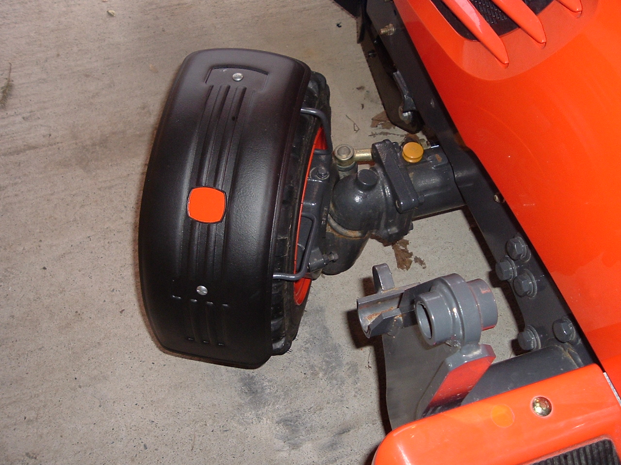

These are the front fenders that John Deere sells for $32 each the brkts are what I made up total cost under $75 for both they seem to be very strong and durable Ive had them buried in the snow over the wheel if any is interested in making I will send more details

Thanks lowboy, I have been waiting for these pics. I plow multiple driveways in my suburban neighborhood with my gc2310 and I need a pair of these to keep the salty slush of "Red Hot" while I am driving the roads. Could you possibly post some more pics of your mounting set up? Did you just weld nuts or washers to the ends? (I need to go back and read the previous posts!) And do you happen to know the part # for the fenders?
Great Job by the way, they look fantastic!

Nice job ... Did you use Kubota gray paint or an after market brand (it seems to be a good match)

Why you may need fenders , When I mowing tall grass after you cut it it is a little wet from the cut, then when you make your next past around some of it sticks too the front wheels and thrown on the mower deck i, if you mow alot of acers this builts up on top of mower deck were that double V belt is and makes it smell like burn't rubber it cost is about $80 , since I put the fenders on it has stopped the grass by 90% also it stops the dirt when rototilling with the mower deck on , I guess I'm too lazy to take it off Ps. JD# AM133907

I'd like all the info you got, even the part# for the fenders. Also maybe a pic of the mounting with the front wheel removed. When you come up with a protector for the boot on the steering, there are a bunch on here that will jump at that also.:)

for me, though, i need more clearance to get the chains on and off in the winter. i'm planning to do a mount on the bracker where the loader attaches. the fenders would be fixed, but i'm only interested in keeping grass and snow/salt water off the foot pads and mower deck when going straight anyway, so it's not a big deal for me if they don 't turn with the wheels.
thanks for posting the pics. just out of curiosity, what did you bolt the brackets to? are they attached to the lugs some how or to the outer axle case?
