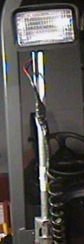

1) rear facing light: looking for one (similar to what I've seen on police cars) that is on an articulating arm and has a length of "springy cord" so you can detach it from the monting and use it as a hand-held light around the tractor. Saw similar one on an ATV site a while back...but can't remember where. Anybody got one of these? Website? model #?

Regarding #1, I replaced the SMV sign with a bracket, light, switch and coiled cord. This way I can remove it when not needed or needed elsewhere, it adjusts up and down, left and right. I can even stick it in the ground when I don't want to hold it. Here is a picture....
Have fun,
Michael

Thanks Michael.
I just removed my SMV sign a few days ago 'cause it was in the way. Was thinking I could use the bracket for something. Was at Wllyworld a while ago pondering over the same idea you had in your pic.
