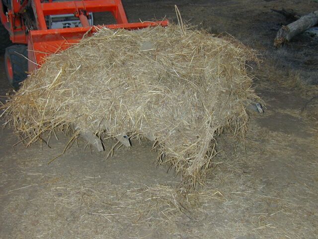

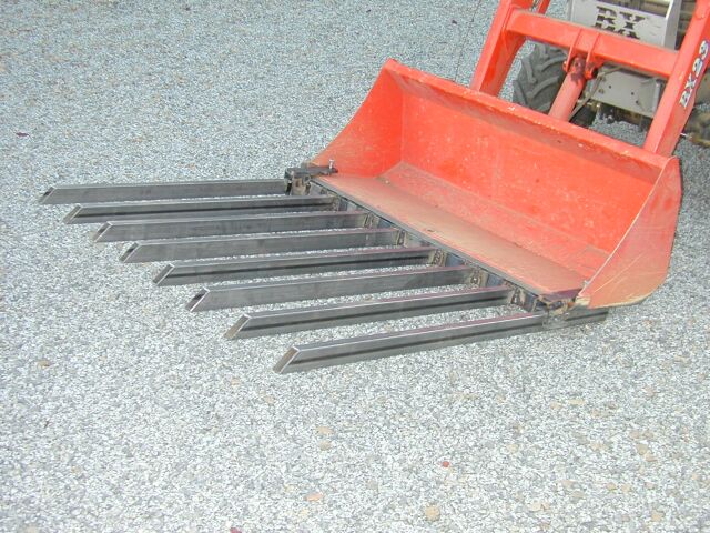

A Q&D (quick & dirty) solution to picking up brush and especially cut grass/weeds while sifting out dirt. Most material is 1" x 2" x 16ga tubing. Weight is about 50# ... just right for a "lawn tractor on steriods".

Yep

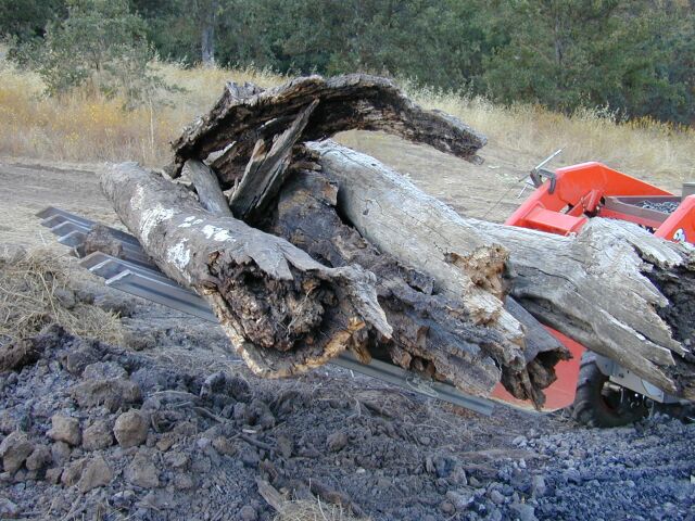

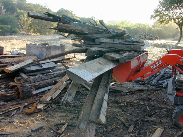

Last night was a trial run with the brush forks. I just used tacks to put it together. Tonight I used nails as well as put caps on it's teeth, and tested it for more aggressive chores. These tasks required poking the forks into, and/or along, the surface to pop out timber and logs. I am satisfied with this creation for now ... time will tell though.

ok
