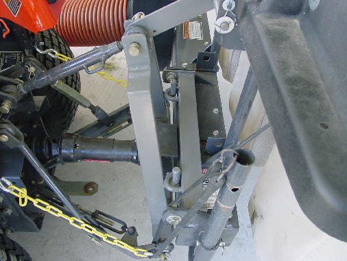

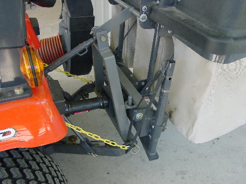

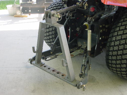

I also encountered same problem with bagger, was very disappointed with design as compared to BX and other implements. Really need two people to hookup bagger !!!
After 3-4 times installing/removing bagger I decided to figure another way. I Designed system that utilizes 3 pt. hitch and hydraulics. I will try to take some pictures and post them today along with description...

Apologize for taking so long to get pictures. Be advised there is some drawbacks with the setup I have, the most important is the fact that the MMM and 3-PT raise and lower at appx. the same time, not independently. When I have to raise the mmm to transport I have to disengage the pto as the bagger will raise with the MMM and bind the pto shaft. No big deal except you need to remember or there could be damage to the u-joints. If I can be of more help, let me know.

Did you look into getting a three point quick hitch before making your own?
