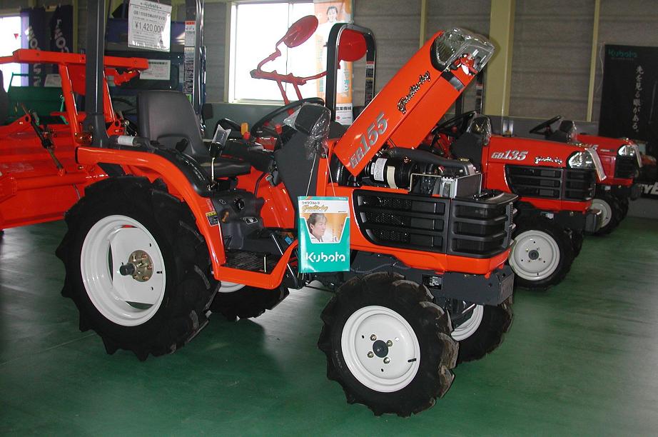

Attached is a photo of the 15 HP Kubota Granbia-Boy series model GB155 that is marketed in Japan. This photo was taken last November. /forums/images/graemlins/smile.gif
This series has 5 models in the range of 10.5 to 17 HP.
Guess what engine the GB155 uses?
You got it! The D905, rated at 15 HP @ 2,500 RPM!

Sure looks like it since the tractor I attached the photo of above uses the 905, and they have rated it 15 HP @ 2,500 RPM.
Have to wonder what forcing the engine to run at 3,200 rpm, for 540 pto rpm, will do to its longevity. /forums/images/graemlins/frown.gif
