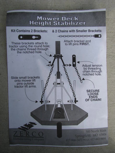

On the BX models there is no position control so you must set the position yourself or add some form of hard stop like the limit chains.

The engineering on commercial Limit Chains is more advanced then it appears. Order the correct Zercos from the LINK Post #2. $30

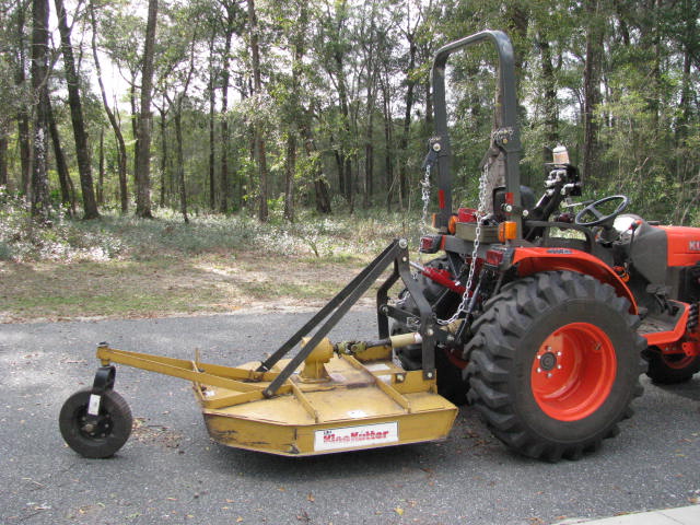

I use homemade limit chains and tailwheel for height setting.
