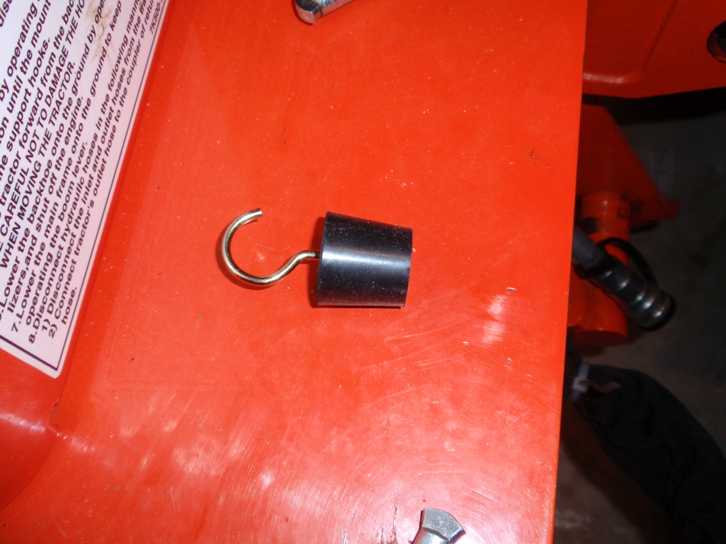

I pulled my trans suction strainer today and checked it. It was clean. Re-installed same and added @ 1/2 quart of Super back. I have a drive on ramp so this makes the job easier than if you had to go down below. I fabbed up a "finger" made from paper towels with electrical tapes around it. Used that for a plug while I cleaned the strainer, worked fine. I have about 25 hours on my machine. :thumbsup:
So no oil change, just filter cleaning this time

I did my 50hr. fluid and filter changes about a month ago on my BX25 and it came time to do the strainer I purchased a #5 tapered rubber plug and put a screw in hook in it for easy in and easy pulling out.

Getting tractor ready for this summer, been neglecting servicing on it due to moving and just didn't have time. Gave it a quick wash and rinse before starting the TLC process. Anyway, just did my 50 hr (at 150hr mark) service which ended up being full service changed all Engine and HST filters, and fluids.. screen was relatively clean with just a few particles (thankful). Did purchase rubber stopper to have just in case from Home Depot (largest one they carried worked fine). Tried to purchase an additional HST screen at tractor store just to have to swap out but at 60.00 that idea was quickly vanished. If you drain the oil there is very little that comes out the screen port but rubber stopper keeps port closed while you clean the screen. Went ahead and just changed the USDT fluid as I had 5gal bucket anyway.. oil looked fairly good considering the amount of use it has had last year.
Why does Kubota have a filter and a screen? Seems that reasoning is little overkill. The pump should send fluid through the filter first shouldn't it? If so should not the particles be captured by the filter in the first place. Or is this the return fluid screen that captures large particles coming from the implements before it gets reused?
