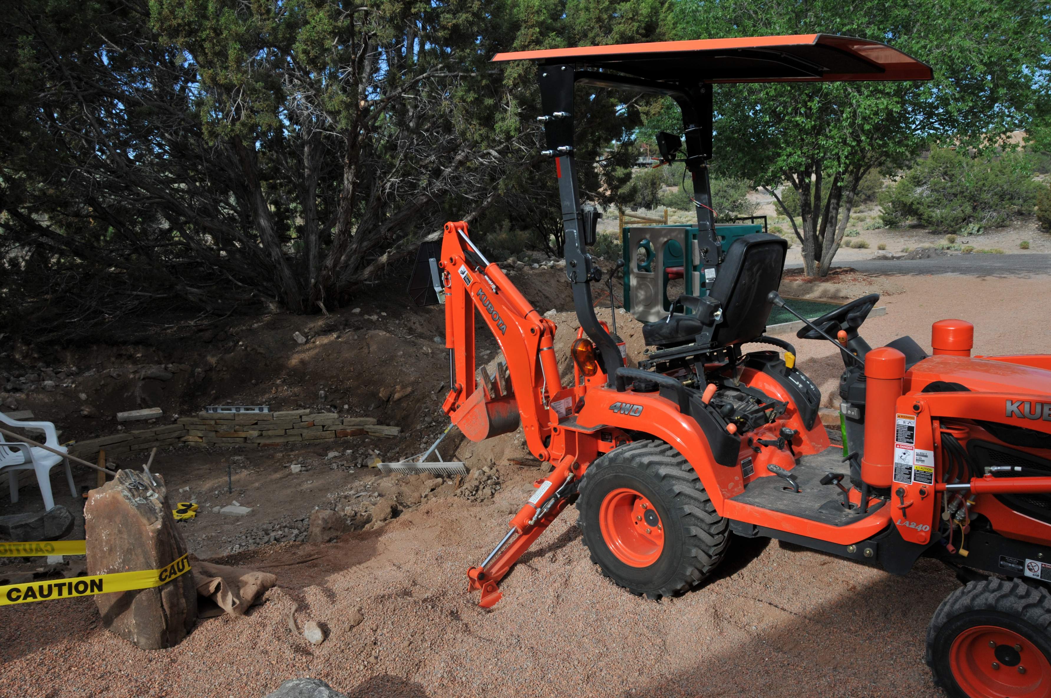

The picture is my new tractor (after 50 hour of use and the 50 hour service) with 2 tool boxes (holders) I made. The design is based on previous posts that I saw on here.
I first built the 4" diameter pvc with two end caps toolbox which I mounted through the existing hole on the left FEL posts. It is mounted with cap nuts, a couple of bushings, a threaded rod, lock washers and a couple of nuts. I sanded the top cap and it simply slides off and on easily and smoothly. I like the way it came out but felt it needed to be just a bit bigger. I wanted to be able to fit a small claw hammer.
So I built another one that is 6" diameter, moved the 4" to the right post and thats what I have. The 4" fits well on the right because the FEL control box is there. The 6" would not fit on the right side. They are both the same height. Also, I put a clear trim (door trim guard bought from auto supply store) where the cylinder meets the post and a small square x 1/4"thick rubber material at the top of the post to shim it parallel to the post.
I keep wrenches in the little one and all kinds of stuff in the other. Here is the pic...

Looks good ! :)
   / BX 25 Tool Boxes #3
Hey Rome, Terrific idea, I like it. So darn difficult to find good tool box locations on tractors. You've certainly sparked some ideas for me! Nice.
Thanks,
. . . tug
   / BX 25 Tool Boxes #4
great job!
Yes it's hard to find a good place for a toolbox on a tractor.
Thanks for sharing.
