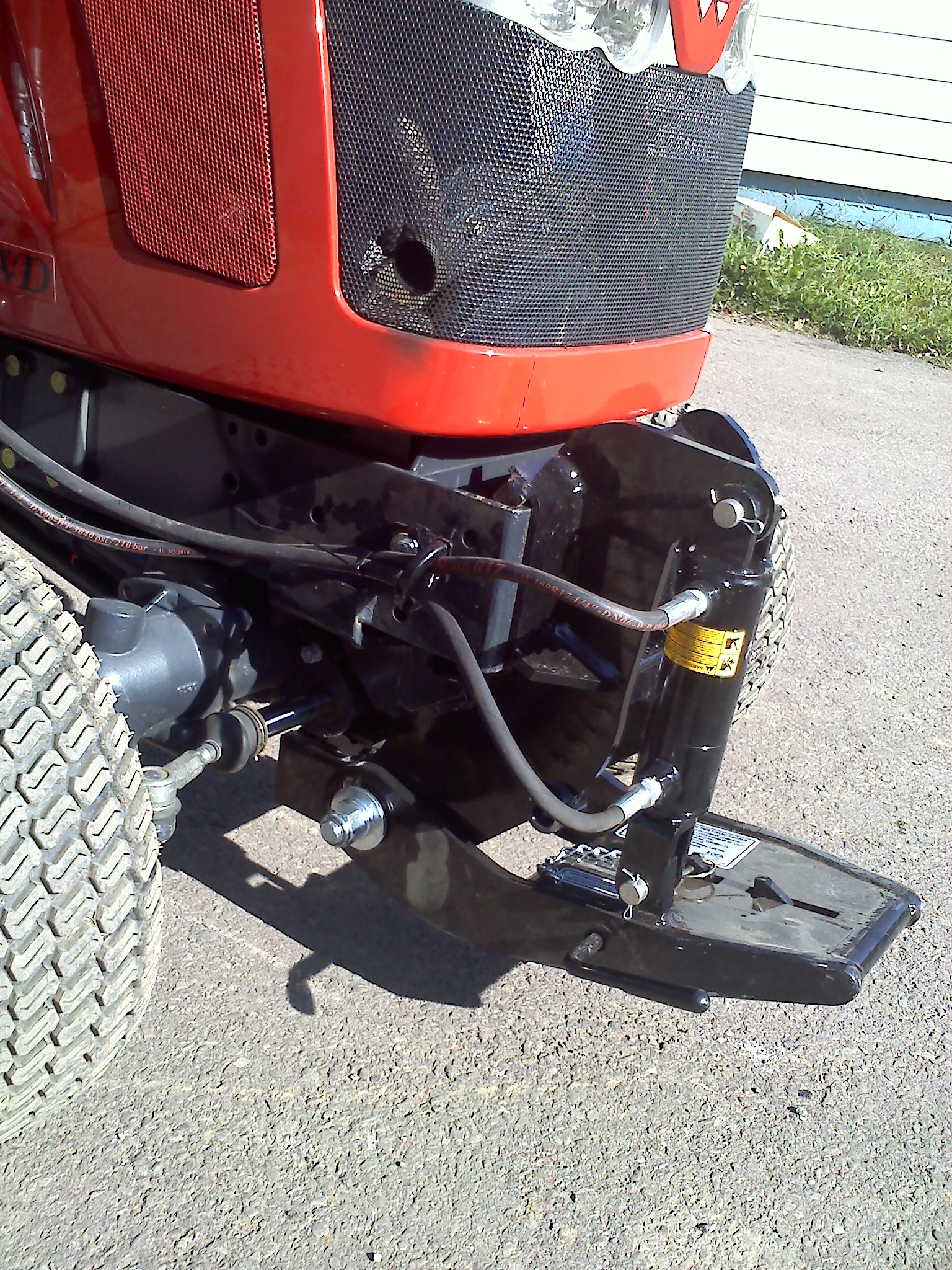

Questions?? I have a BX 25 and looking at a snow blade set up. Will probably get the QH for it first and then save up to get the blade or adapt a used one. Does the QH when installed interfere with the FEL? Hope not as that would queer the idea for me. Second question; can you keep the FEL on when the snow blade is on? I realize that I would have to one when the other is working as they both use the FEL hydraulics. That seems easy to set up a mechanical block mechinism. It apperas easier/quicker to drop the blade than the FEL. I could probaly add a second set of valves and maintain the PB circuit as a further refinement also.

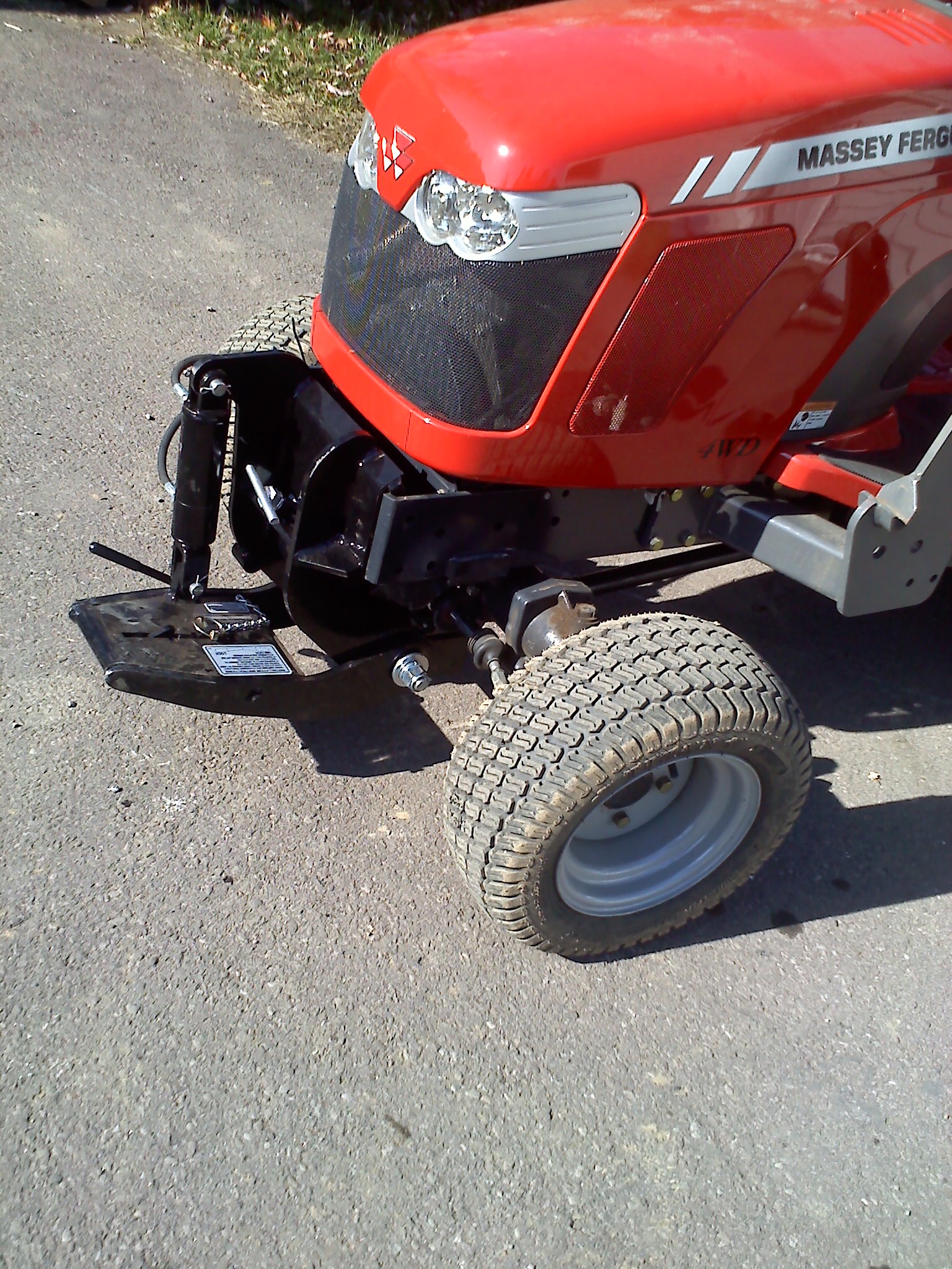

The quick hitch won't interfere with the FEL, but it stays very close to the ground. I don't think you will be able to use the FEL and the blade at the same time.
If you can drop the hoe, and use a backblade, that might be a better alternative.
Here is a picture of the quick hitch on my Massey

I don't know about the Massey but on my bx24 if does interfere somewhat. If your using the blade zoned not the blower it only takes 2 minutes to put the hitch on and off. A quick on plow that attaches to the bucket would probably be better. Look at the one from bxpanded.

The QH on my bx does interfere with the loader. If it doesn't interfere on your Massey then your lucky. Makes life better if the QH could stay on. I only mean to give him suggestions and endorse no products. But I do see your point about possibly being dicey
   / BX 25 FEL/Front QH #6
I can't even hook up my loader when I have my quick hitch on :( I have to take the quick hitch off every time I want to use the loader.

The hitch for Kubota and Massey are the same. The blowers are the same, just different paint and numbers.
I coulda sworn that someone said the hitch could be left on with the FEL installed on the BX, i could just as easily be mistaken.
But with that aside, if you plan on moving anything other than snow with the plow, you would want the frame mount type or a backblade for on the 3 pt. hitch.
The fel is easy to drop, and on the Quick hitch, only one 'T' bolt holds it on and 2 hydraulic lines. I also have a driveshaft on mine that takes a few seconds to connect or disconnect.
