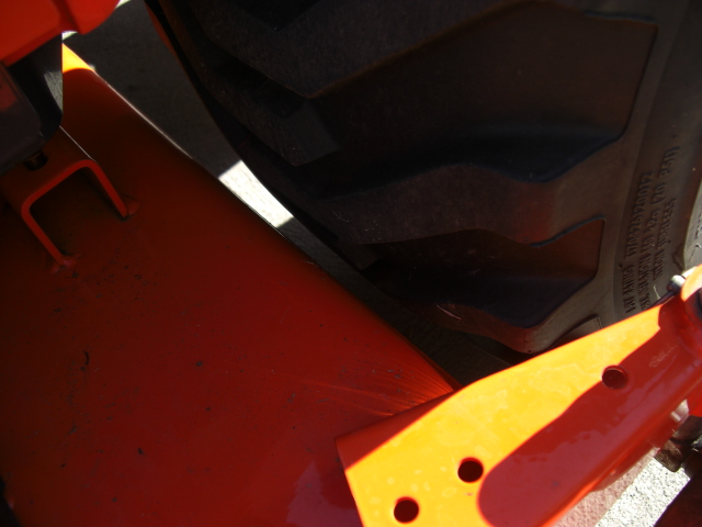

Finally got round to installing my bro-tek wheel spacers ! Well what a difference as I am on hilly ground my first test piloting was quite successful it was at least 30% BETTER STABILITY no more of the puckered up bottom contractions;) I run my BX 24 with a 60 inch MMM deck and there were no conflicts with the wheels ,just a slightly different way to install and take off the MMM. A bit different when doing it DOWN UNDER RICHARD BRO. A big Kiss from my wife to Richard Bro-Tek for making tractoring much safer.

Very nice! The only thing I see that needs improvement is the keyring style to hold your scalping wheels in. I replaced my with hairpin clips and its much easier now to removve/install the MMM.;)

Are the spacers difficult to install? Are they for the rear wheels only? When you say that installing the MMM is a little different, can you elaborate a little?

After doing research on this forum some time ago and speaking to Richard at Bro-Tek on several occasions it came quite apparent that the wheel spacers would definitely be a must as my terrain is steep, hilly, rocky and has plenty of dips that destabilzers the tractor and gives me never ending freckle contractions :D In the previous post I mentioned that it was a 30% better ride 2 inches makes a big difference:D either side.
Installation is simply Richard at Bro-tek sent me a link on how he installs the wheel spaces. My way might be slightly different here we go. Safety first ,parking break on sturdy wood blocks at the ready for under the tractor. I loosened off one wheel first before lifting the wheel off the ground with the back hoe stabilizes 3-4 inches max. You will need a 20mm socket (long body) and an extension to get the original wheel nuts off. Once off the Bro- tek wheel spacer will take the place of the wheel ,put back the original wheel nuts into the spacer once again using the 20 mm (long body) socket making sure the nuts are snug and tight at this stage Richard recommends using a torque wrench . With the wheel spacer in place now put back on your wheel this time you will need a 19 mm socket as Richards nuts are slightly smaller;) Repeat for the other wheel.
Fitting 60 inch MMM did require a bit of extra maneuvering to get it on but all in all it went on the same as before the wheel spacers were fitted. Getting it off I did have a little conflict with one of the scalp wheels it must have been the key ring thing ! Hey Radioman:) That was my first time I will perfect the technique and I"ll take some more photo's but dont let that put you off purchasing .
