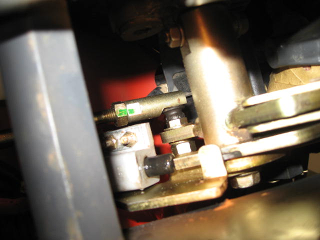

I went out this morning to clear some snow from the driveway and I fired up the tractor. I backed it out of the garage to warm it up outside. I hopped of the seat and the engine quit and now it won't restart. I am guessing its the switch that senses when the HST is in neutral. I tried to find a switch on the floor pedal and can't seem to find it. Unfortunately the tractor is out in the snow instead of the nice warm garage. Any ideas on where the switch is? The machine is in neutral and the battery seems fine since it fired up in the garage. I did plow yesterday for a few hours and I stopped a neighbors to chat and it did not start right away like it usually does. It did get it going after moving a few levers and talking to it politely. The operator position switch seems to work since the engine quit when I raised off the seat.

Its not a fuel problem, the starter motor won't fire. Its some kind of electrical switch that is not doing its job. I looked at the PTO lever and wiggled it and its in the same position its always been in.
When I raised off the seat this morning, the engine just quit. It acted just like when you are moving and you sit up on the seat, the engine dies. It seems like the switch for the HST or the seat switch. Since the engine died when I raised off the seat, it seems like the seat switch is working fine. The glow plug light comes on when I move the ignition switch, but turning the ignition switch further does not fire up the starter motor.

If it died when you raised up off of the seat, it will be the HST pedal switch. Try rocking the pedal back and forth while holding the key in the start position.

Another thing that it may be. Neutral shift lever switch. Move it back and forth while holding the key in the start postion.

May be slightly different between 23 (treadle) and 24 (2 pedals), but I suspect not. Per my WSM, the neutral switch is back where the linkage enters the transaxle (WSM sez to R&R rear wheel to get to it)...

I found the neutral switch and it was not being activated. The linkage has an arm that comes out and hits the switch when its in neutral. The arm is loose and it slid off to the side so it didn't hit the switch. I can't see what it takes to fix the problem permanently, but it's running. I tried to take a picture of it, but of course the batteries died in my camera. The switch is back where the linkage enters the transmission.

♠I put the tractor on the jacks to fix the pedal neutral switch. I took a couple of pictures to show the misalignment. I bent the plate that holds the switch and the linkage now aligns with the switch. I'm not sure what caused the linkage to come out of alignment since its buried way up between the frames, but its working now. I haven't posted pics before so I hope it works.
