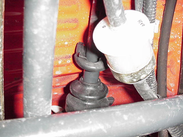

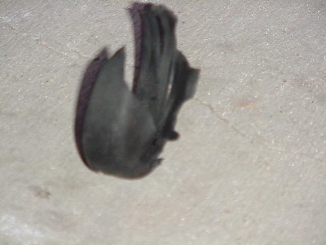

Hey Junkman,
Wanted to get back with you on this problem with vibration on my BX23. Well, I haven't used the tractor that much since I noticed this problem, but I have started it up to get it out of the way to do other stuff. After I backed it in the barn, I turned it off and looked under the tractor again and saw this rubber sleeve that looked like it attached to the driveshaft just in front of those hydo cooling (plastic) blades. My guess that a stick from my clearing of the tree got up in there and tore it enough to have it get caught up between the drive line and the undercarriage of the floorboard and create the vibration... /forums/images/graemlins/confused.gif? Anyway here is a picture of it.

   / BX 23 vibration
And another closer up. What is this thingie called...a dust whatchamacallit?

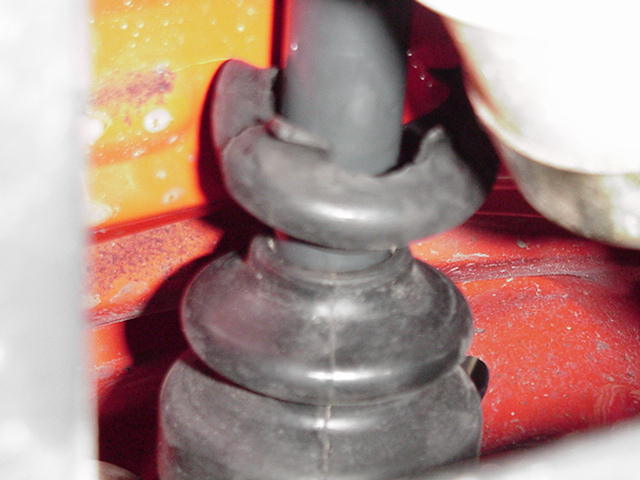

   / BX 23 vibration
Yet another. Better angle, closer up. How important are these? Do I need to replace them?

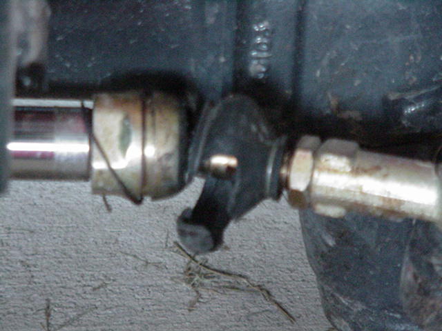

   / BX 23 vibration
#9
Now this is a picture of the front wheel suspension. These dust cover thingies over the pivot dealies near the front tiers have been torn off also.
My question is, do I need to replace these? What is their purpose?

   / BX 23 vibration #10
They are very important. That is all that keeps the grease in and the dirt out. I don't know what they are called by Kubota, but on an automobile, they are referred to as "boots". I haven't looked at them on my tractor.... (the wife is calling me for dinner), but I know that it isn't going to be easy or inexpensive. The bearings will also need to be cleaned and repacked if they are what I am thinking of... Good luck and stay out of the brush.... it is a tractor, not a bulldozer!!!!! /forums/images/graemlins/blush.gif /forums/images/graemlins/blush.gif /forums/images/graemlins/blush.gif /forums/images/graemlins/blush.gif /forums/images/graemlins/blush.gif
