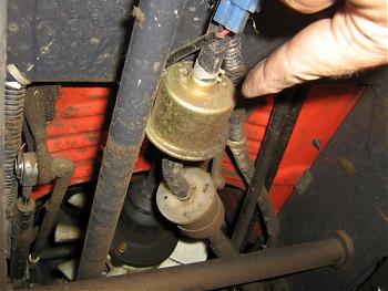

SO... here's the current dilemma. I was under the tractor reconnecting the fuel pump, and it just doesn't look right. There's a bracket on it, but it's not attached to anything. The pump is supported by the fuel lines, which are stretched taunt. The wires running to the fuel pump are also stretched tight. I check through the manual, and it shows two filters, one of which is near the fuel pump. Obviously, somewhere along the line, somebody decided they needed this fuel filter more than this tractor did... OK - I now have new filters on order -the question is - which way does it go? My intuition says the filter is between the tank and the pump, and the fuel flows from the tank, through the filter, then the pump, and then to the engine. But if that's the case, why did the tractor run for at least an hour (that's like 60 minutes if your using the metric system) with this fuel line disconnected? Is this possibly a fuel return line? If not, and the other fuel line is the return, is there someway the fuel return line was able to pull fuel from the tank back up to the injectors?

The fuel system has a line from the bottom of the tank to an inline filter, then to the pump, then a second inline filter, the to the injector pump. The injector pump has a return line that runs back to the top of the tank that they call a return line. At least that's how it's supposed to be. Diesels shut off by stopping the fuel flow since they don't rely on spark to run so I don't think you caused any damage from fuel starvation. I think your repairs to the electrical system will fix that problem anyway.

All - thanks for the advice. Yeah, I thought about the air inlet, but in all the excitement, I couldn't figure out where the air filter was pulling air from. I was so focused on cutting off the fuel supply I didn't think hard enough to chase the air path out at the time. In this tractor it pulls air via a duct that's behind the battery access cover. I hadn't had the battery cover off before, so didn't know it was there at the time. For sure, next time, I'll be ready.
Anyway, just got new filters. So... anyone know which way the fuel filter gets installed? Photos? Anything?
