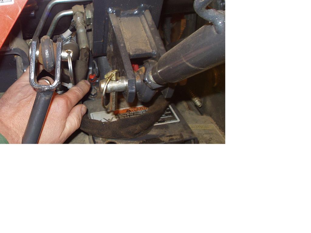

If you read the different posts, some backhoes seem more productive at less than WOT than others. Can the hydraulic fluid level effect the outcome?
Speaking of which, can someone point out where to check this. Have 37 hours and never checked this level. I do grease ever 10.

</font><font color="blue" class="small">( can someone point out where to check this)</font>
Attached is a pic of where the dipstick is on the BX23. It's described in the owner's manual on p. 64 "Checking Transmission Fluid Level". The same fluid is used for all the hydraulics (backhoe, transmission, etc.).

I think that I saw a piece of a finger that looks like it belongs on that hand in a cup of chilli..... /forums/images/graemlins/grin.gif /forums/images/graemlins/grin.gif
