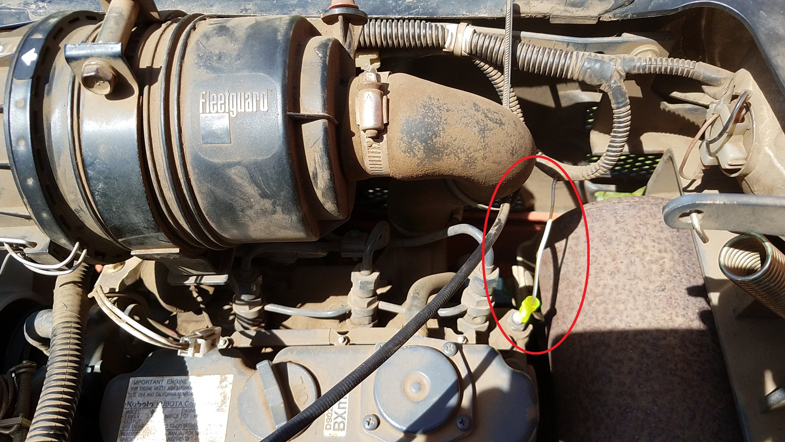

By the way, When I first started having this problem, i saw a single, white, 4"-long piece of wire coming out of a wiring harness and one end just hanging in the air. There was a blade connector plugged onto the engine block that the wire was clearly supposed to connect to. I bought a new connector, crimped it onto the wire and plugged in onto the block, and the engine started up. (See attached picture) That worked for a couple of weeks, until yesterday, when the tractor wouldn't start. I don't underestand how either of those thing would make sense. I'm going to re-check that right now.
Thanks again.
Tim
   / BX 2230 Glow plugs and dash light #7
The white wire looks like it plugs unto a coolant temperature sensor.
It would not affect anything other than the dash display.
Dave M7040
