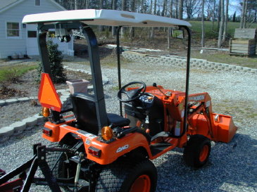

Since getting a BX 2200 a couple years ago, I have wanted a canopy. I have looked at a bunch that others have purchased and made. Visited many web sites looking for affordable canopies, including Steve Carver's site. Saw Steve's message about the canopies getting scratched in shipment. Could not decide which one to purchase.
Then on 2/12/2003 Danny Williams posted a picture of a canopy he put on his BX 2200 in the Buying/Pricing Forum (see attachment). I recognized the top Danny used - it is off of an EZ Go Workhorse. I really liked the looks of Danny's canopy, so sent a message asking if he would consider making a set of supports for me. Since Danny does not have a Kubota FEL (he built his own), there was a question as to whether his metal supports would work in my BX. He shipped a set to me to try. They fit perfectly. The only problem was you would have to take the right front support off each time you removed or installed the FEL.
I took a few measurements and pictures and sent them to Danny. After he thought about it for a while, he and I decided on a different design. Danny fabricated the new supports and sent them to me. While they were in transit, I purchased an EZ Go top.
My EZ Go dealer sells new tops for $250 or used ones for $100. Since I plan to paint mine Kubota Orange, I decided to go with a used, white top.
Danny's reworked supports arrived this week, along with the hardware: two U bolts to attach the back bracket to the ROP; and bolts for attaching the top to the supports, and for attaching the front supports to the floor of the BX. Took about an hour to install the brackets and top. It was a perfect fit. See the next post for a picture.

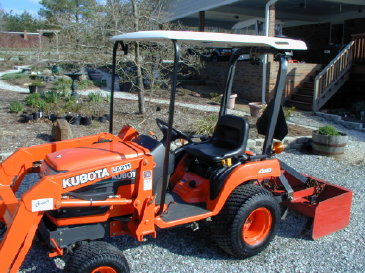

This is my BX 2200 with the new canopy.
The brackets and top are very sturdy and allow the FEL to be removed/installed without the front supports getting in the way. The front supports also provide a good hand hold when getting on and off the tractor.

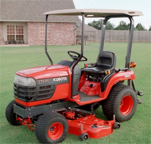

I installed a mirror on the right side, and will probably add a tilt meter to the left side.
Many thanks to Danny Williams for putting up with me and fabricating a set of supports for my BX 2200. These pictures, plus the ones he posted of his bumper; canopy; and FEL show his work is very high quality.
For the final test, took the wife out to see it, and she said it was "neat". Danny, looks like your work passed the ultimate test.
Thanks again for all your work on this.
