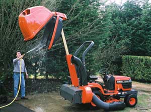

Picture of it dumping and being cleaned.....

I agree with you on that, it sure looks like a nice set up. I had seen it linked from someones post a couple weeks ago and thought the same thing. But from the looks, I would bet it is quite a bit more expensive. It does look like it would still be the same pain to hook up, but dumping would be very nice.
