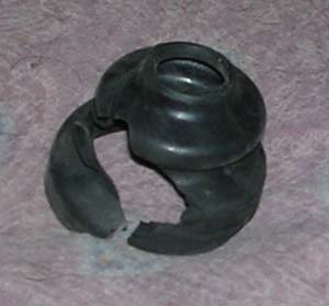

Yesterday I was running the tractor when I started hearing a loud THUMP, THUMP, THUMP of something hitting the floorboard of the tractor from underneath. I had the mower deck on (but not running) and could not see anything. I took the deck off, climbed under and found (attached photo) the boot where the main shaft comes out of the engine decided to rip and fly around with every revolution of the engine. But seeing how it's just a boot to keep dirt out of that connection of the shaft, I don't think it's necessary as long as I don't drive in a swamp. Any other opinions?

If it were me I'd replace it as soon as possible. I wouldn't want any dirt/grit in the bearing. I think it's cheap insurance against a more costly repair down the road. just my 2 cents

If this item wasn't necessary, then Kubota wouldn't have installed it in the first place. The purpose of this boot is to keep dirt, dust, water, etc. out of the joint. I would replace it ASAP. The part number is K2561-14130, and can be found on page 132 & 133 of the parts manual. The cost from www.tractorsmart.com is $1.25 and $5.00 shipping. Cheap enough to purchase a spare. If you ruin the complete front joint, then the cost will rise to $45.65 plus $5.00 shipping...... your choice.. /forums/images/graemlins/grin.gif /forums/images/graemlins/grin.gif

I had the same thing happen to me. BUT it hit the wire to the fuel pump and destroyed the connection. See this thread from about a week ago.
web page
It did not damage the boot I just slid it back on. As you know it is only held on by friction. Yet again ANOTHER poor design by Kubota. /forums/images/graemlins/mad.gifYou would think it would be held in place by a strap. As the rubber gets old it is bound to sag, hit the rotation shaft and fly off.
