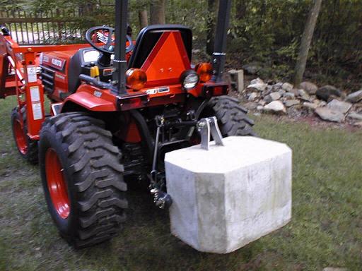

I made one of these weights for my bx-22 it is 400 lbs.
(Not sure who originally posted this picture but I used the idea.)
