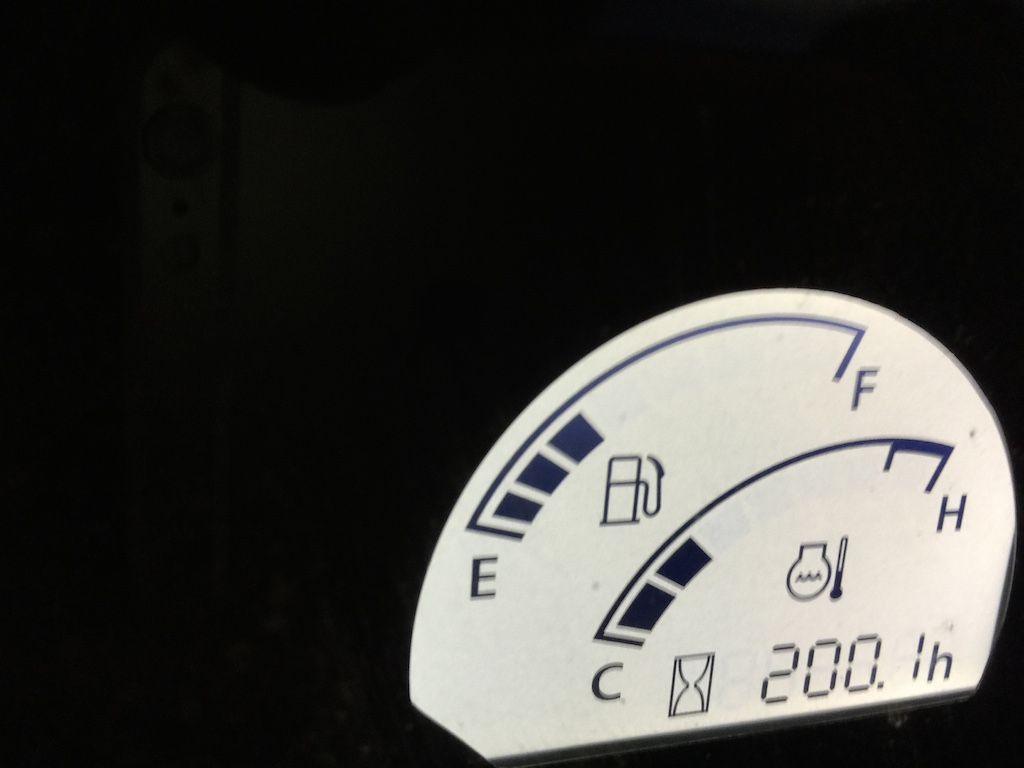

Okay Gents (and the rest of you),
I just finished the 200hr maintenance on my BX. I have had my machine from new and it's been 15 months.
IMG_2950.JPG A few observations...

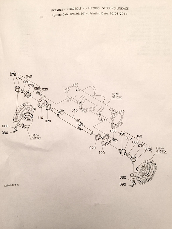

4. Noticed the boots on the steering linkage (on both sides) were worn bad and I picked up a couple of new ones at the dealer.

4. My boots are cracking but they dont look as bad as yours. Maybe a spring project. Were they easy to replace?

aside from the interim maintenance i really hadn't had any issues in the first 200hrs. aside from dry-rotted boots on both ends of the driveshaft and both tie rod ends. fortunately, particularly regarding the former, this was covered under warranty!

Slim, my day job is getting in the way but I will do the reboot hopefully this weekend and post pics of the job.
