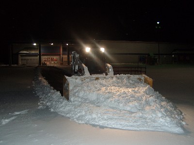

I have a Bobcat S-250 here is a pic from a couple weeks ago. I think you should go with Cat or Bobcat, The Deere's are using 10 year old technology still. Whatever you get make sure it has the two speed option, it's the only way to go for moving snow.
   / buying new skid steer, JD 317 or IR S185 #10
Forgot picture
