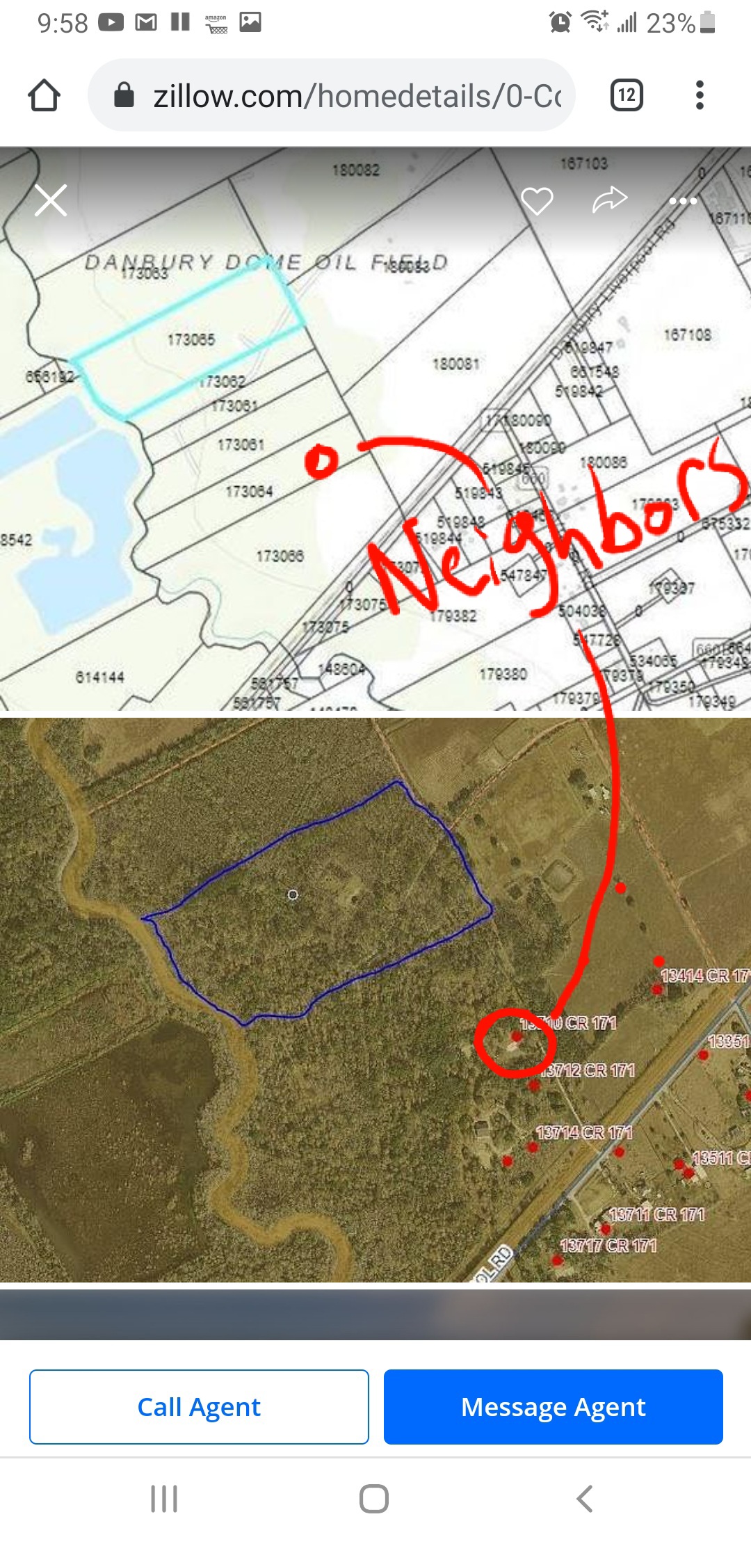

I'm looking to buy some land and there's one property I'm interested in, but it's on an oil field. The price is very good compared to other properties around the area and it has been on the market for a while. Makes me hesitant. Good, reasonably priced land sells within days around here. The land backs up to a bayou and I know that it floods. I would be building up considerably to put a house on it. Half the land around here floods and people still pay high prices for it, so the flooding doesn't tell the whole story.
Another potential red flag is that it's totally wooded. 90% of the surrounding areas are rice farms or used to be rice farms. The fact that it was never deforestated and turned into a rice field tells me, at a minimum, that it is unsuitable for farming rice. I don't care about that. I'm not a rice farmer. But does it signify something more? Is the land unsuitable for any other purpose as well? I actually WANT wooded land. Wide empty fields are bleak to me.
The only good reason I can figure for the low price of the land and its failure to sell, is the oil operations. On Google earth I can see a few tanks on it, looking old and rusty. Does not look like there's a whole lot going on, and those images are old. I imagine there's even less going on now.
I have some financial preparations to make before I approach the realtor, and between now and then I intend to become better informed and know what are the right questions to ask. I used to service oil field equipment so I know a bit about the technical side of drilling and whatnot, but I know little about oil field operations and even less about how those operations impact landowners.
Do any of you have land with oil operations on it? What wisdom can you bestow? What should I know before walking into this? What questions should I ask? What answers are deal breakers? Is this a safe place to move my family to?

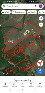

I do not know this for a fact, but I can say with reasonable confidence that mineral rights are not included. Not at that price, and with oil operations already ongoing. So I don't want this to turn into a discussion of mineral rights, unless they effect me in some way that I'm not aware of. When I try to google on this topic, all I find are discussions of mineral rights. None of that applies. This is just a topic of surface rights and how surface owners are impacted by mineral operations.
I do not know exactly how high the water gets. The property is in the 100yr flood plain. I know the "neighbors" - the people who live about 1/4 mile south. Their house is built on a mound I would estimate to be about 8ft higher than the surrounding land. I assume that further into the process I will have to get an elevation survey done, which will tell me how high structures will need to be built up to be safe. I intend to dig a rather large pond to obtain the dirt needed. Maybe I'm being naive, but I think I could probably do the work myself on weekends over the next many months with my 40hp tractor, as this property is within tractor driving distance from my current residence.
