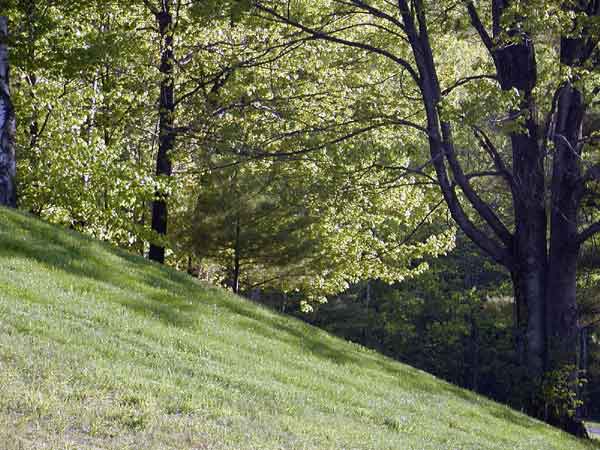

Charlie's early posts on the forum sent me right off to Tazewell to get me an 1845 just like his. It's been the most useful tractor I've ever owned, hands down.
I have nearly a mile of roads and wood roads which I maintain with the 1845. In fact, I've even built from scratch a few hundred feet of light duty road with it using the Bush Hog SBX720 six foot box blade I adapted to the 1845. It's a little slow for moving huge amounts of dirt but for annual maintenance the box blade works quite well. In addition I use the small bucket to dig ditches and an 8ft landscape rake to clean them. And PT's 6 foot plow for snow removal.
Like Charlie, I have single wheels rather than the duals which gives me good maneuverability in the woods, far better than any cut. Traction is simply amazing. Some of the terrain I traverse while mowing etc is as steep as 30 degrees (not 30%) which is about as steep as I feel comfortable on (see attachment) with the single wheels. Beyond that there is too much side slip to say nothing of the pucker in my drawers /forums/images/graemlins/tongue.gif
As far as I can tell, whiterabbit, my terrain, both on the roads and in the woods, is at least as steep as yours and were I to replace my tractor, it would be with another 1845.

Good point. The 28 degree grass you see is on my customer/neighbors property which I mow for him. He has several spots that steep, and steeper. In fact just down hill from that picture it goes to 30-32 degrees and the slip sliding begins. My property only has a few little spots that steep and if I weren't mowing for him I might very well consider the 1445 for its greater torque and heavier duty tires. My 1845 tires have seen many punctures in 700 hours and while the extra torque would be most useful at 30 degrees, there are times when digging or pulling the box blade that some more torque would be helpful. Yeah, I guess a 1445 would be a better choice if it will handle your slopes. PT introduced the 1445 back in '03, shortly after the fire ate my 1845. At the time I was considering the 1445 as a replacement for my totalled 1845 and put together this model comparison chart. Both models may have been upgraded since then but maybe it's still useful. As it turned out I was able to buy the hulk of the 1845 from the insurance company and rebuild it and didn't need a replacement.
