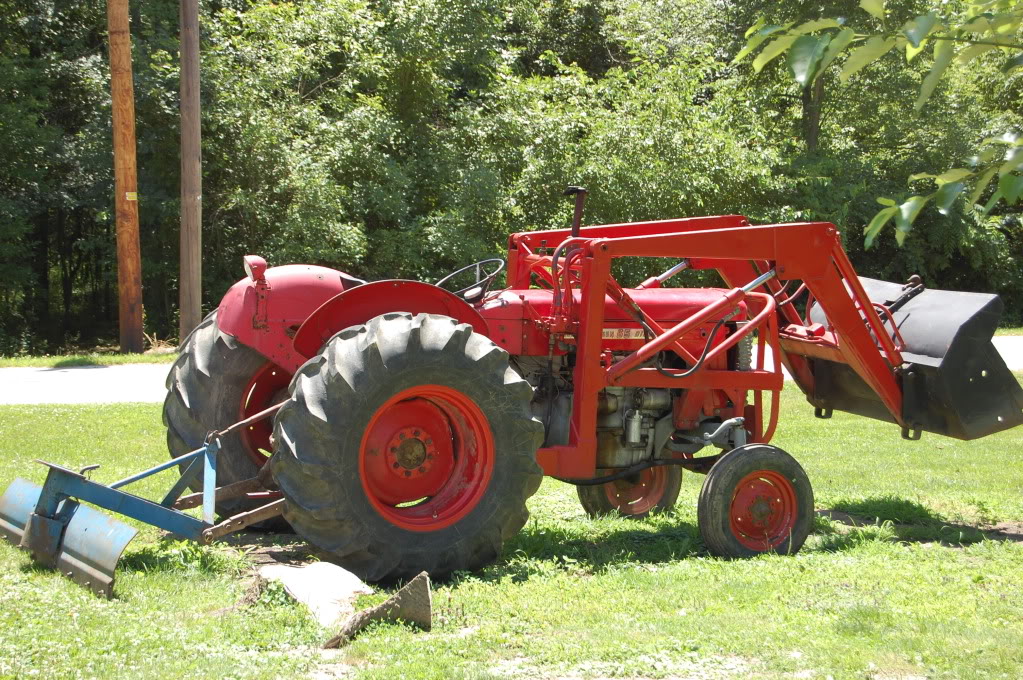

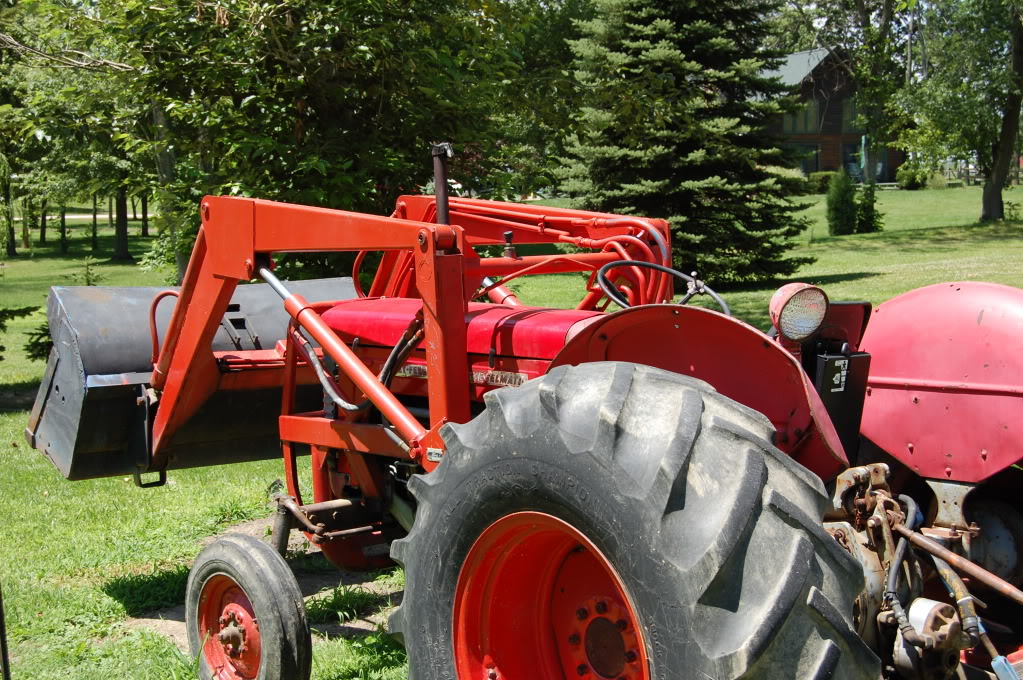

I did see 2 pictures of it, the tires are still in good condition from what I can see, its stored inside, very little rust... looks clean...
   / buying an older massy
here are a few pictures of it, looks decent to me.

Well, to pick it apart... for a better footing for a better price :) The rears are almost gone, not much tread left. Tires are expensive to replace. The suicide knob is broke, take off $200 for that.

Just from the pics it isn't terrible looking.
It does appear to have varying shades of paint on it...........was the hood replaced or have different parts been used to assemble it? I understand the loader has been repainted. Hood and fenders are different tones of "sun-baked." Could be nothing.
Rears are less than great but if you're just messing around on your 17 acres....a little mowing here, a little loader work there, etc.......then as long as they hold air they should still work well for you for a while to come.
I'm all about the fluids. I look for leaks on the tractor. I want to know where it's usually parked and I want to see that for obvious sign of leaks on the ground. Check all dipsticks and the radiator to see if any big red flags go up with any of them.
Turn it over, run it a bit, see if it feels and sounds right, etc.
If all is as it appears and it's just an honest, used 40 year old tractor with all the things that go with it..........then 3500.00 clams is a good buy.
