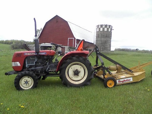

My first CUT was a 15hp (PTO) Shibaura SD1500AO. It was a 2 cylinder and had rice tires. It sipped the fuel and was a brute. I had a 4' rough cut rotary mower, and I cut trails through brush that was eight feet tall! No guards, and I had to put an overrunning PTO adapter on it. I sold it to buy a John Deere 850. I almost wish I had been able to keep that tractor. I only had 2 complaints. Kind of a cramped work station, and tippy on side hills due to narrow stance.
Having said that, you will be surprised what you will be able to do with these tractors. Which one feels better to operate (controls, steering, ergonomics, etc.)? I am guessing the Iseki is heavier, has more speeds in transmission, might be wider AND has bigger tires. If all else is equal I would go for the bigger is better approach - especially the tires. Just out of curiosity how much $$ are they asking.
When I bought my first CUT, I wish I could have bought a 40 HP New Holland, but my billfold and my wife said I needed to start with a 15hp Shibaura. The beauty of these things is that you can buy them, use them, and then sell them later for about what you paid for them. Happy hunting!
