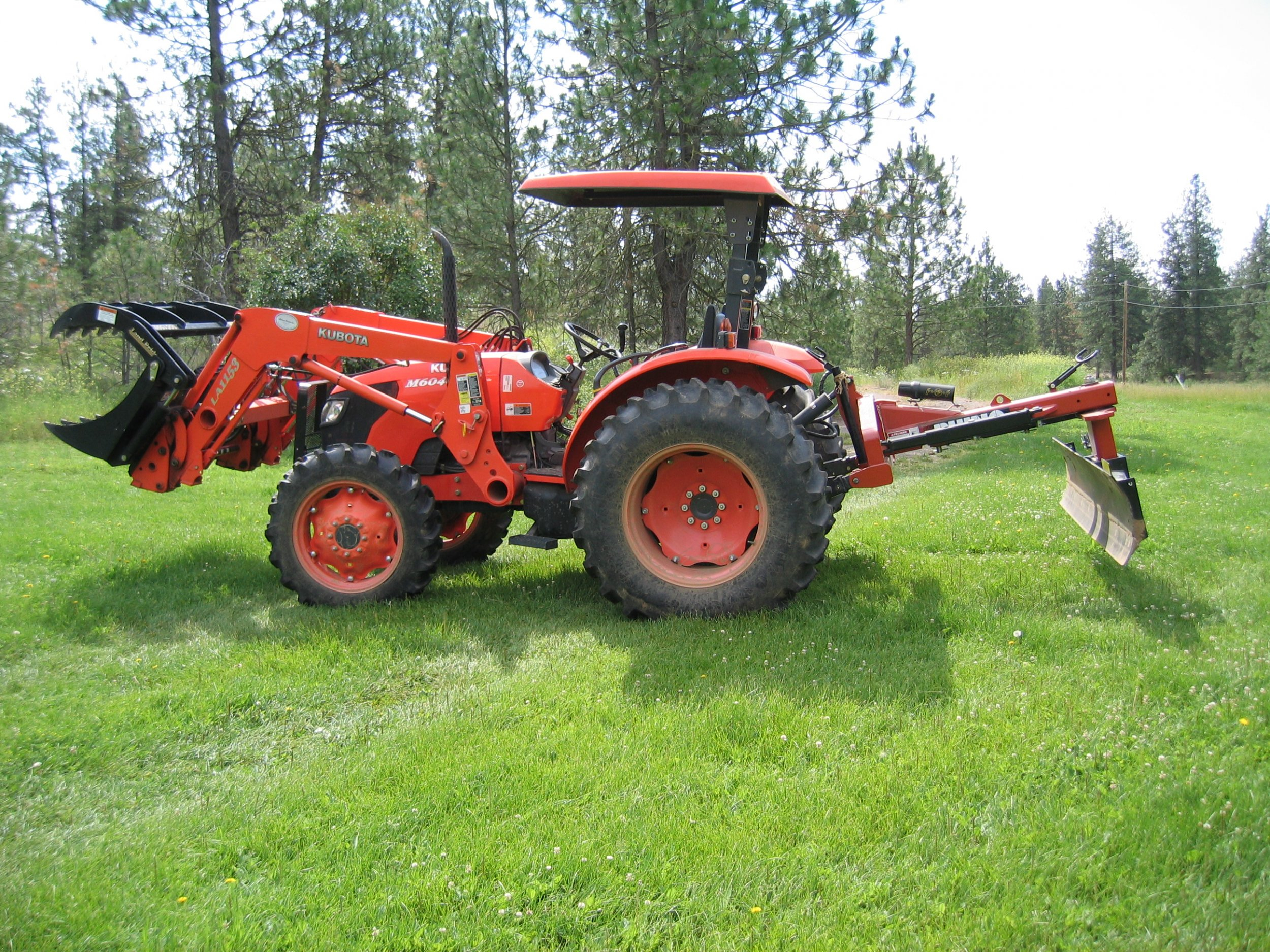

We moved onto the property in 1982 and I purchased a brand new Ford 1700 4 WD that same year. I have a mile long gravel driveway to maintain - had to instal a mile and a half of barbed wire fence - plant hundreds of small trees. It did just fine and in 2009 I traded the Ford in and got a brand new Kubota M6040. That's 27 years with the Ford.
I was able to take on the larger projects with the Kubota. I could plow the driveway snow without needing a 3-point blower. The new tractor is heavy enough, with its heavy Rhino rear blade, to clear the snow berms that form along the driveway. I can now move large rock and pine logs with my grapple. My HD land plane grading scraper( LPGS ) works very well behind my Kubota.
All in all - category 2 implements & an appropriate tractor will do their job faster than Cat 1 implements. Recognize I said faster, not necessarily better.
A picture of my M6040 Kubota. Heavy duty Land Pride grapple & WR Long 3rd function valve. 1550# of RimGuard in the rear tires. 1050# Rhino 950 rear blade - 8 foot. Total weight with this setup - 10,100#.
My property is very open with stands of ancient Ponderosa pines threwout the property. Access anywhere is not a problem with a larger tractor.
I would suggest this. Make a list of all jobs/projects you envision to do with a tractor. How much time can you devote to these projects. What implements will you need along with a tractor. Remember the purchase of a tractor is not like the purchase of a new car. With proper maintenance a tractor can last well beyond a single lifetime.
