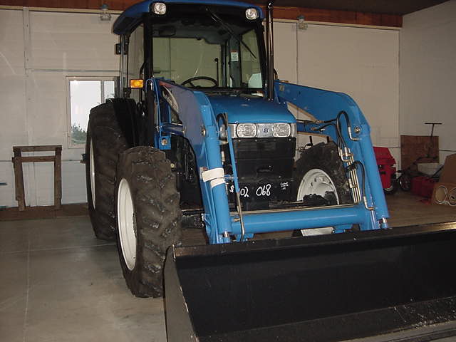

Hi tmag! I bought a NHTN65D in the fall and I really like it. I got the cab model with the NH loader. I was tired of freezing in the winter and baking in the summer. The tractor is awsome and easy to use. NH has deals on financing. I got 0% financing on my tractor. Hard to beat. The most important part of your buying a tractor is to get a dealer that will service your tractor the best. If you buy from a far away dealer, make sure you have a place to get any little bugs or problems fixed under warranty and after the warranty period. Get your best deal on paper and then go to your local dealer and see if they will match it or at least be in the ballpark. Good luck! Ken

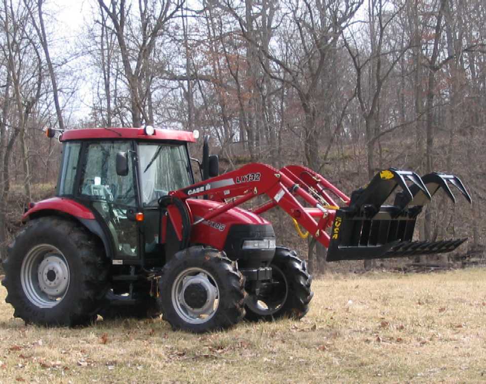

I recently purchased a JX85 with cab and loader. The JX series is a bit larger than the TN. I was looking for a TN also but the dealer had this JX on the lot and would deal. So far I'm very happy with the tractor. I would get a block heater as they aren't expensive.

Tom that is a nice looking JX85 and a mean looking grapple.
