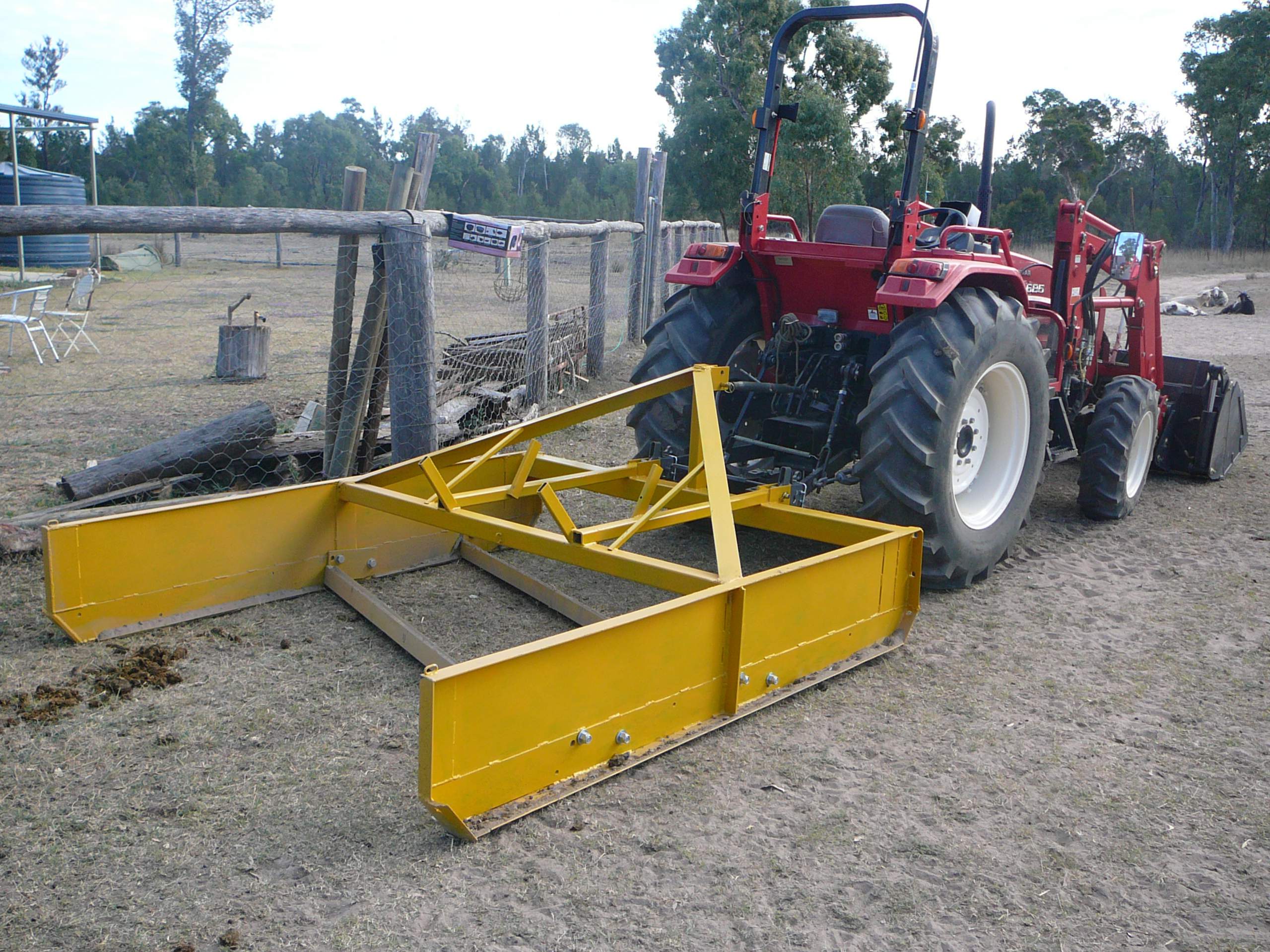

I have made my own with angle blades. They are suppose to move material from one side to the other being angled but the angle doesn't let it move much but I do think it makes it cut good. The moisture content of the soil makes a big difference to how it works. As said before a hydraulic top link would be very handy, I don't have one would like one. Mine is 7' wide and 8' long and it will still lift at the back without good solid pressure from the top link. Great product for road maintenance you will love it when you get one. Does a great job smoothing off in reverse also.
link to my build if you want more info-
http://www.tractorbynet.com/forums/build-yourself/287452-land-plain-blade-height-help.html
