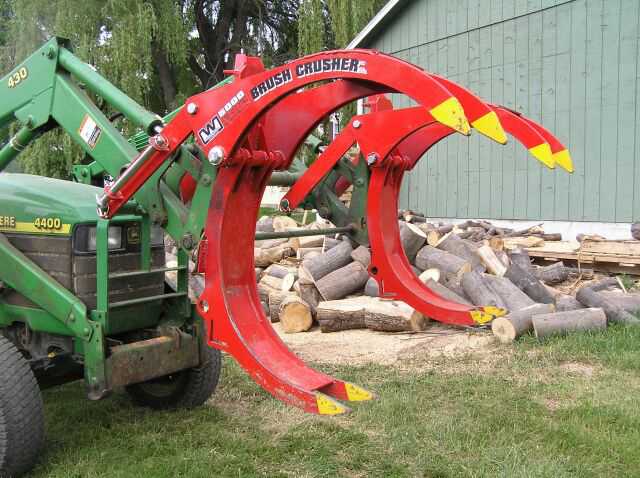

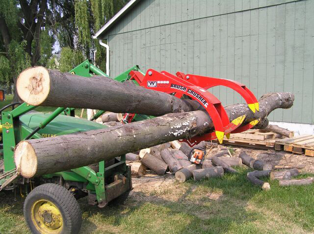

   / Buying a grapple #8
It's a nice looking, well built set up, I know that you can get the finishing rake, but I like the grapple/rake like the AnBo or the W.R. Long. There are so many out there, and all of them are quality (for the most part) just some are better suited for different applications.

http://www.tractorbynet.com/forums/.../87292d1192196083-buying-grapple-p5310052.jpg
Now THAT is a grapple! :D
I've used a grapple with a loader bucket, and it was very disappointing for working with trees and brush. It was very awkward to use, and almost as much trouble as it was worth. More practice may have changed my mind.
The grapple-bucket combo could have been handy for moving rocks and broken concrete, but I had none to try it on.
I've also used a grapple with forklift-style forks. That was 100% better. It was easy to move logs, poles, brush, lumber, and assorted larger junk. There were no bucket ends to get in the way, and the grapple securely held nice fat loads.
The true grapples as depicted in Westdorf's photos aren't quite as versatile as grapples in combination with forks, but are obviously superior for moving limbs, trees, and logs.
