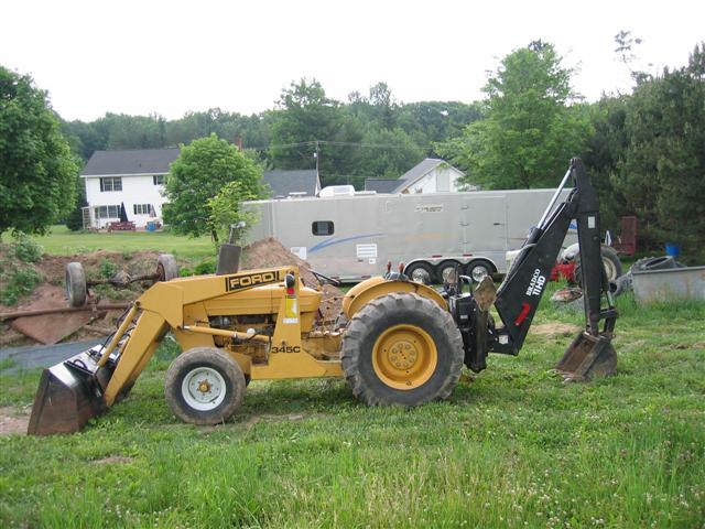

Get a Bradco.

I have an older John Deere hoe [#165] that is manufactured by Bradco. It was a three point type but I made a subframe for it to fit my old Case 430 farm tractor. Power is from a PTO pump at 11 gpm and over 12 gal of oil in the resevoir. All I can say about the Bradco hoe is that it has never failed me once and digs pretty well with no broken parts or cracks. I would like to install a thumb for it next. All in all I think the bradco unit is great.
