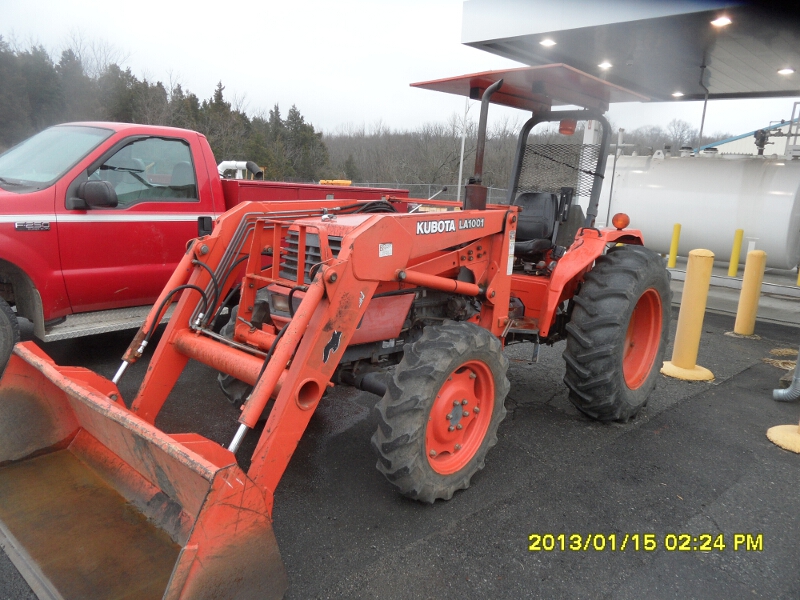

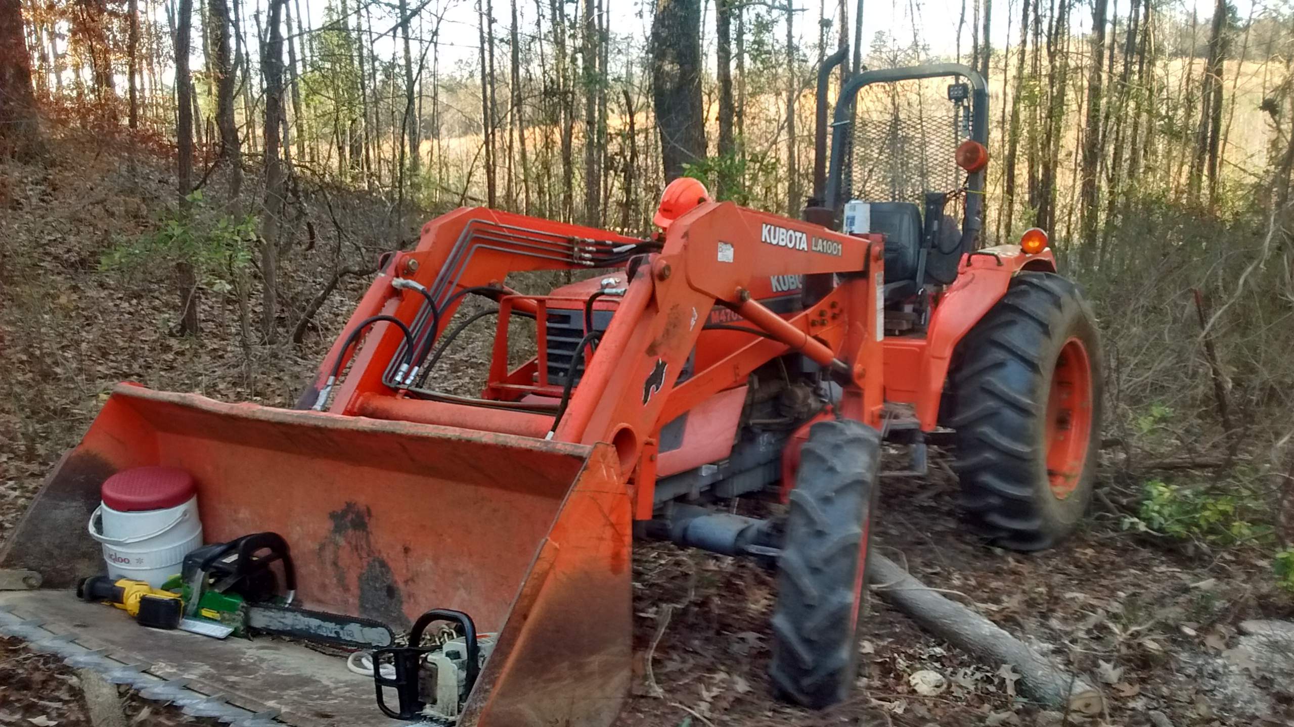

If you are comfortable taking out a big loan by all means buy new. I would expect by the time you add to a 40+ HP tractor a FEL, a bucket, a grapple, pallet forks, a box blade, a plow and a cab you could be looking at $10K for implements, maybe $20K.
I was in a similar situation but I preferred to take out the loans for more land and bought this 50HP kubota in 2013 from Public Surplus auction for about $12K.
attachment.php
It's required about $1K in "repairs", (2 front tires for $600, some hoses etc.) but plays well in my woods.
attachment.php
So the bargains are out there, but it may take a deal of looking. At the same time I purchased the M4700 I ws looking at buying a 40HP Kubota from Barlows for about $16K.
