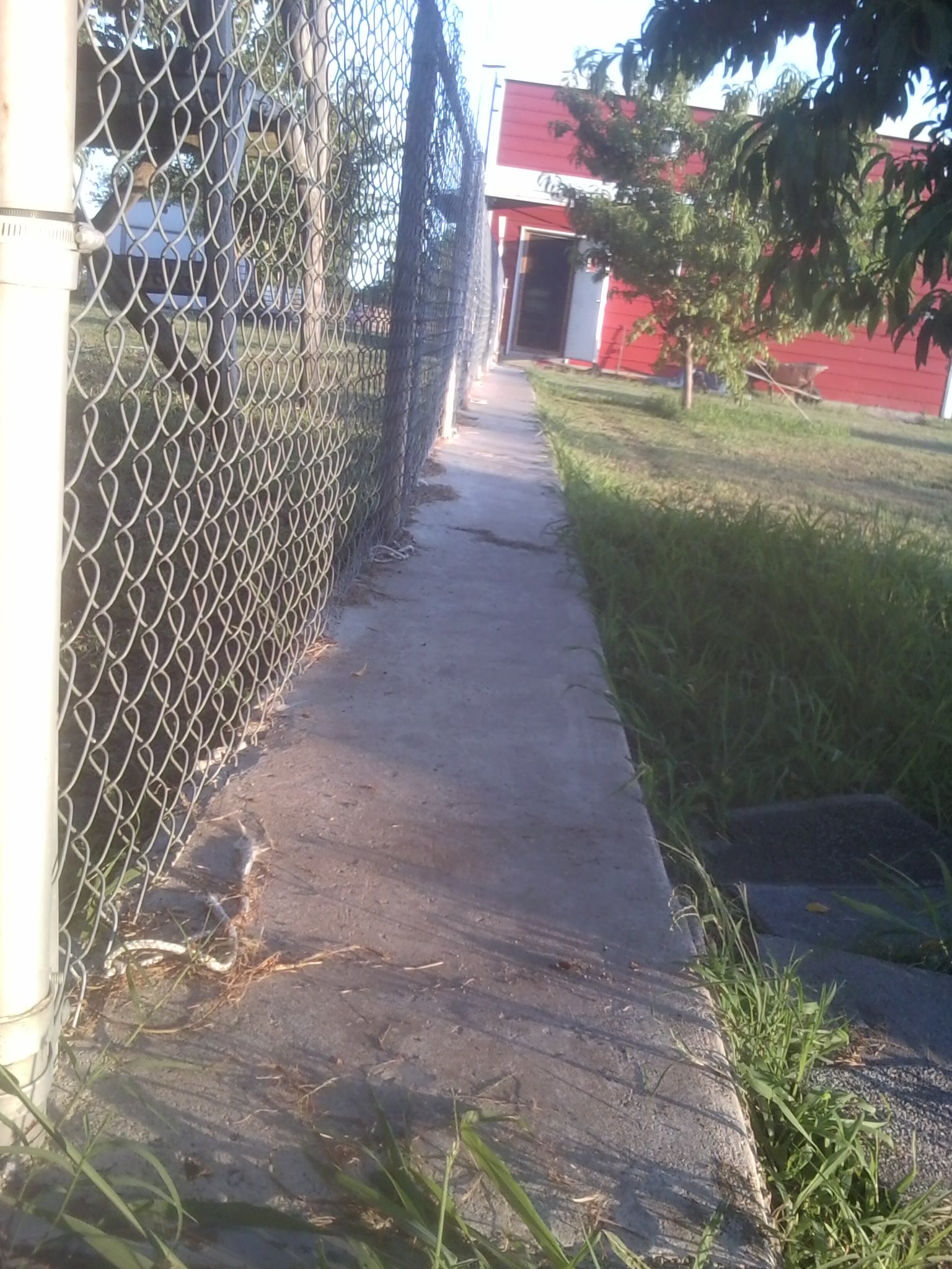

I wholeheartedly agree on the economics of redi-mix. Been pouring and finishing concrete for decades and if you haven't tried the mud paddle (needs to be a good one) for mixing mortar it is the best method for a DIY'er. No waste and if you're working by yourself it is better to mix small quantities anyway. Your mortar should be nice and thick and peak like cake icing when you trowel over the top. Getting it that thick means a lot gets stuck in the drum if you mix not to mention the excessive dust. Also, when I use Sakrete I put the whole bag (3 in mine) paper and all and let it run for 5-10 minutes. The reason you have to add Portland to get a good mix is that a lot of the Portland gets sifted into the double paper liner during shipment.
This 70' sidewalk is 28 bags of 80# poured 3 years ago:
