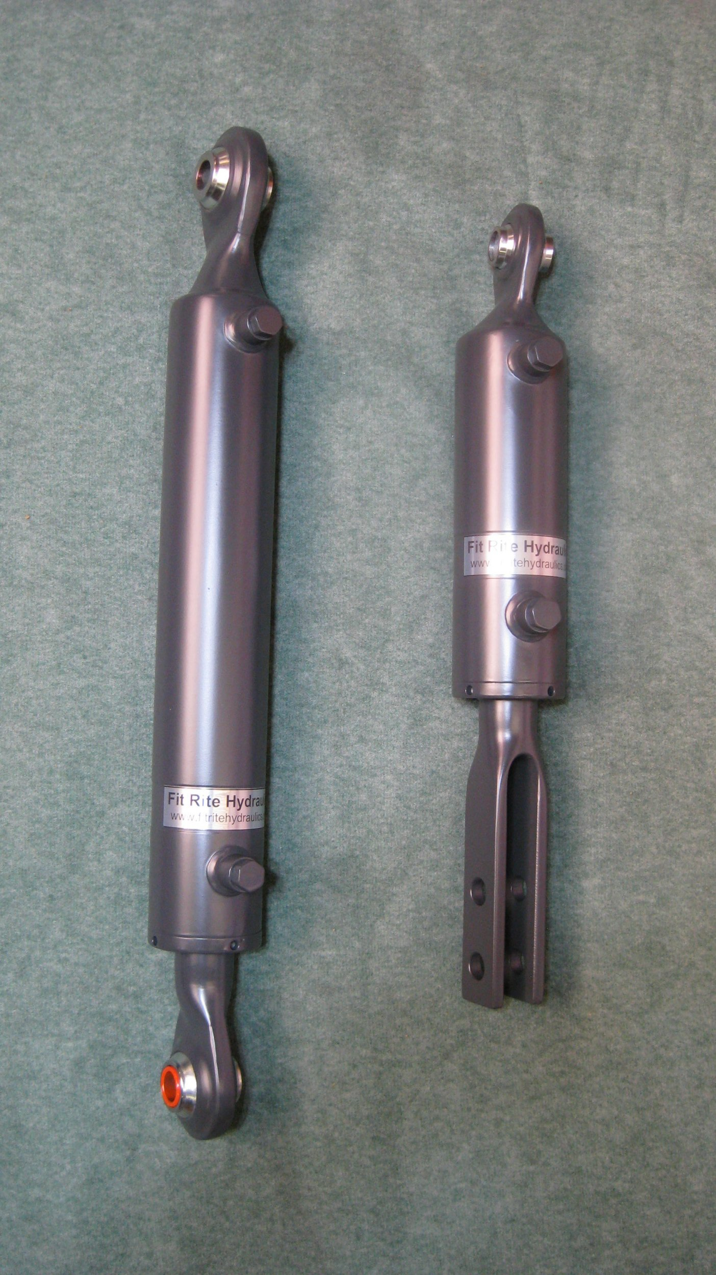

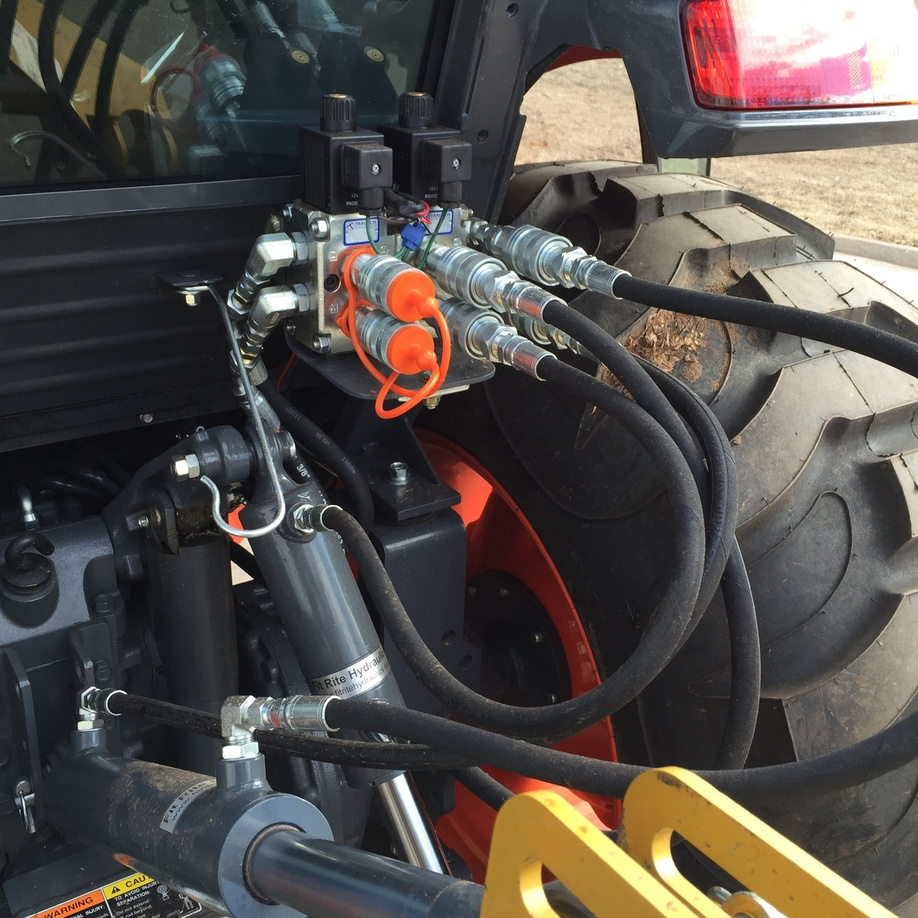

Pictures shows a customer's L6060 that had a single rear remote and needed 3 sets. He purchased a double diverter set to get the 3 sets that he needed. This are all usable without every taking his hand off of the single factory control lever.
Top & tilt set can also be seen in the picture of the double diverter set.
The valves can be added to the L3302 and I believe that Kubota is going to have top & tilt sets for this model soon if they don't already. And of course 3rd party T&T sets with valves are available also.
I would think that it would be pretty hard to pass up a tractor with close to double the capabilities though, and a cab. 👍 👍
