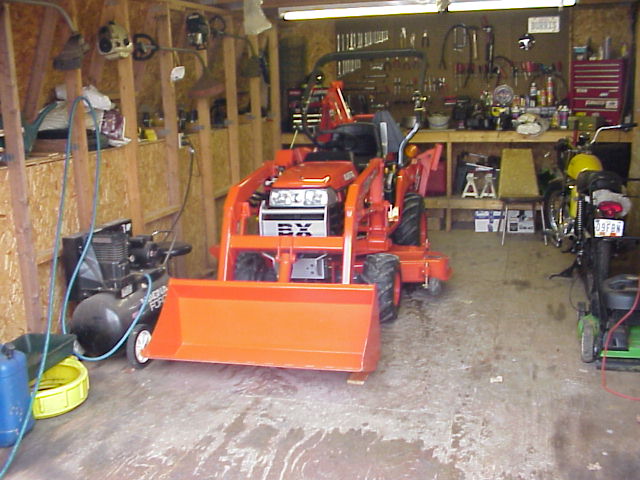

I purchased a 12 X 20 shed kit from 84 lumber and it has been enough room for everything I have. I built a 2 foot wide work bench along the back wall and I have all my power tools hand tools My Kubota BX22, the BX MMM not installed laying flat. Lawn tractor, power washer, air compressor, Triumph motorcycle and few other odds and ends. So I guess what I am saying is that you should have enough room if you go with a 14 x 20. When I built mine I used 5/8 tongue and groove flooring that sits on 4 X 4 floor joists which are supported by cement piers. And it holds anything I have parked in it. All the wall spacing is 2 ft centers.....I used to park a 91 Ford Mustang in it when I first built it. So if you build something like this or better than this it should work fine for you. /forums/images/graemlins/laugh.gif They sure are handy!!! Pic attached
/ Buy a shed or build a shed #4
Let me try the pic again

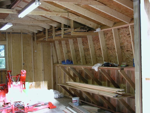

Let me throw in my 2 cents. I needed a new shed last year to fit the new BX22. I looked to buy, to make life easy, but couldn't get the 8'x8' doors I wanted to clear the ROPS.
I ended up building a 16'x20'. Hip roof (I think, barn style), with 10' at the peak. For the foundation, I used PT 6x6's set on level ground and stone. The 6x6 are in a grid. I filled the spaces between the 6x6 with stone, leveled. On top is 1/2" OSB. Sounds weak, but I used it in the old shed (15 years ago). The stone gives the support and the board the nice surface. It holds the BX no problem. It is much cheaper than concrete, and in the locale, it is not considered a fixed structure, so it is not taxable.
The side walls are T1-11. Framing is 2x4 for the walls and 2x6 for the roof. Doors are 2 4x8 sheets of T1-11.
Overall took about 2 months of after work time, including razing the old shed. Total cost was under $ 1100. This was about 1/2 the price for a better shed.
paul
/ Buy a shed or build a shed #14
rogue:
A shot inside
paul
