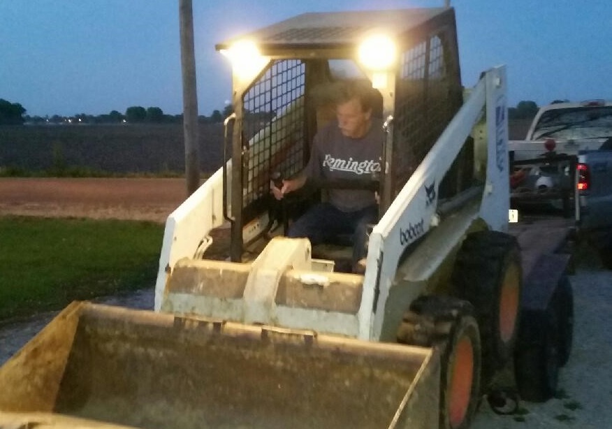

Got the cat for 8500 and the trailer for 400

That is a decent price. I bought mine for right around that price with 3400 hrs. Close to 5000 now. Keep telling my wife you are going to use it to bury me.
/ Buy a Bobcat 753 ? #13
Thanks for the pic. Good price for the hours.
